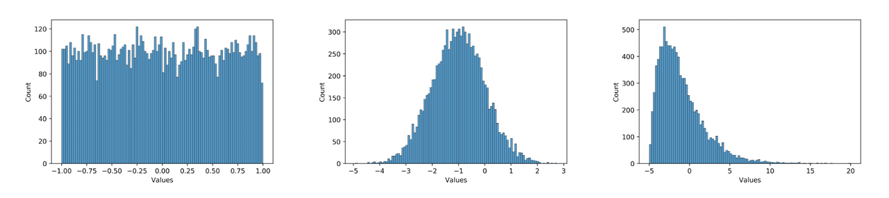

  4. Unreasonable data distribution. The plugin uses uniform symmetric quantization, so zero-mean uniform distributions are optimal. Long-tail distributions and outliers should be avoided as much as possible. Additionally, the numerical range must match the quantization bit width. For instance, using int8 to quantize uniformly distributed data in the range [-1000, 1000] would clearly result in insufficient precision. For example, among the three distribution diagrams below, from left to right, quantization-friendliness decreases progressively. Most values in the model should exhibit a distribution similar to the middle one. In practice, use debug tools to check whether the weight and feature map distributions in your model are quantization-friendly. Due to model redundancy, some operators with seemingly poor quantization-friendly distributions may not significantly degrade final model accuracy. Consider this alongside actual QAT training difficulty and final quantized accuracy.
data_distribution

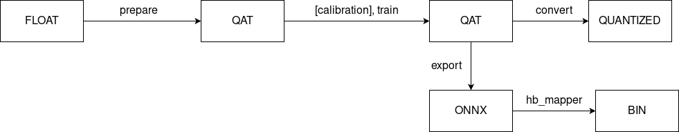

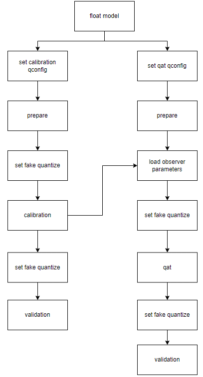

The overall workflow of Calibration and QAT is shown in the figure below:
quick_start
Each step is introduced as follows:
  1. Build and train a floating-point model. Refer to the Obtain Floating-Point Model section in the horizon_plugin_pytorch Quick Start chapter.
  2. Insert Observer nodes into the floating-point model. Refer to the Calibration section in the horizon_plugin_pytorch Quick Start chapter. Before using the prepare_qat_fx method to convert the floating-point model, you need to set qconfig for the model.
    model.qconfig = horizon.quantization.get_default_qconfig()
    get_default_qconfig can set different observers for weight and activation. Currently, available observers for calibration include “min_max”, “percentile”, “mse”, “kl”, and “mix”. Unless there are special requirements, we recommend using the default “min_max” for weight_observer and “mse” for activation_observer. See the Common Algorithms section below for special usages and debugging techniques.
    The fake_quant parameter has no effect on Calibration results; keep it at default.
    def get_default_qconfig(
        activation_fake_quant: Optional[str] = "fake_quant",
        weight_fake_quant: Optional[str] = "fake_quant",
        activation_observer: Optional[str] = "min_max",
        weight_observer: Optional[str] = "min_max",
        activation_qkwargs: Optional[Dict] = None,
        weight_qkwargs: Optional[Dict] = None,
  3. Set the fake quantize state to CALIBRATION.
    horizon.quantization.set_fake_quantize(model, horizon.quantization.FakeQuantState.CALIBRATION)
    There are three fake quantize states in total. The model’s fake quantize state must be set accordingly before QAT, calibration, and validation. In calibration mode, only statistics of operator inputs and outputs are observed. In QAT mode, both statistics observation and fake quantization operations are performed. In validation mode, no statistics are observed—only fake quantization is performed.
    class FakeQuantState(Enum):
        QAT = "qat"
        CALIBRATION = "calibration"
        VALIDATION = "validation"
  4. Perform calibration. Feed the prepared calibration data into the model. During the forward pass, observers collect relevant statistics.
  5. Set the model to eval mode and set the fake quantize state to VALIDATION.
    model.eval()
    horizon.quantization.set_fake_quantize(model, horizon.quantization.FakeQuantState.VALIDATION)
  6. Validate the calibration results. If satisfied, you can directly convert the model to fixed-point or proceed with quantization training. If not satisfied, adjust parameters in the calibration qconfig and repeat calibration.

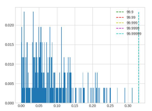

Input and output distributions of different ops in the model can vary greatly. A single global percentile parameter may struggle to meet all op requirements. For high-accuracy needs, first find good global parameters using the above method, then use debug tools to identify a few ops with large errors, and set percentile parameters individually for these ops. Refer to qconfig setting methods for details. Below are several common data distributions prone to large errors:
calibration_percentile_longtail

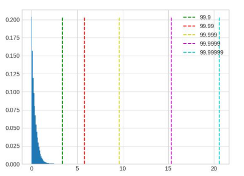

Extremely long-tail distribution: percentile should be set smaller; 99.9 in the figure is a good choice.

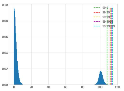

Excessively wide range with scattered distribution: retaining or ignoring tails leads to significant accuracy loss. Avoid this during floating-point model training by adjusting parameters like weight decay.

Workflow
hybrid_qat_workflow
Use prepare to convert the floating-point model into a QAT model, train it, then export to ONNX format, and finally use the hb_mapper tool to convert it into a bin model.
Note:
Users can obtain a heterogeneous fixed-point model via the convert process for accuracy evaluation purposes.

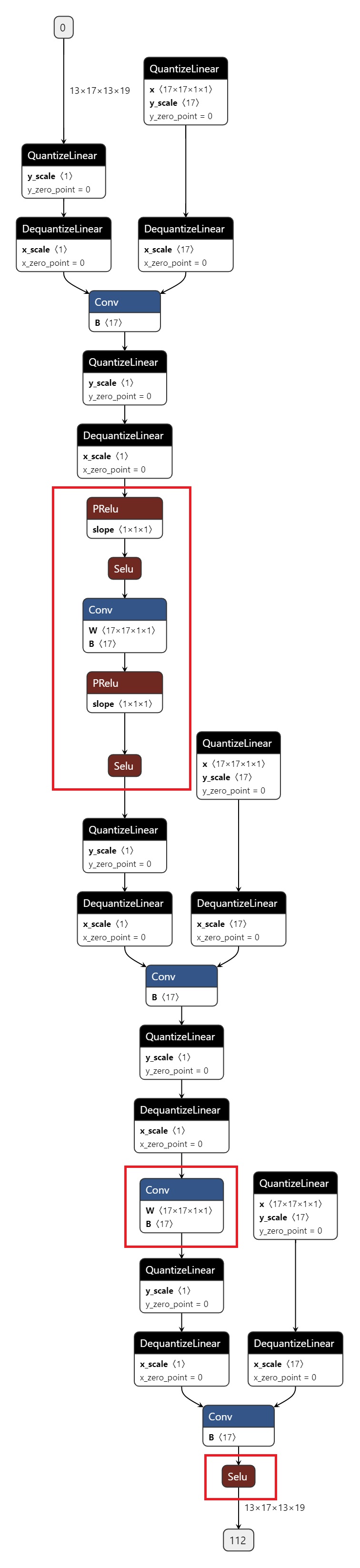

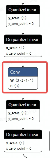

The exported ONNX is shown in the figure below, with the CPU operators highlighted in red.
hybrid_qat_onnx

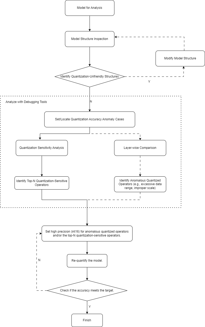

When encountering accuracy degradation in a quantized model, we recommend following this workflow using the precision tuning tools:
  1. Check the model for quantization-unfriendly structures or abnormal configurations;
  2. Use the QuantAnalysis module for detailed analysis, with the following steps:
    1. Identify a bad case as model input. A bad case refers to the input for which the outputs of the baseline model and the analyzed model differ the most;
    2. Perform quantization sensitivity analysis. Empirically, the top-n operators ranked by L1 sensitivity are often quantization-sensitive (the value of n varies across models; no automatic method exists yet, so manual tuning is required, e.g., top 10, 20, etc.). Set these sensitive operators to high-precision quantization (e.g., int16) and re-run the quantization flow;
    3. Alternatively, compare input/output information layer by layer between the two models to detect operators with abnormal data ranges or unreasonable scales, such as operators with physical meaning that should use fixed scales.
The overall workflow is illustrated below:
new_debug_flow
A complete example is shown below.

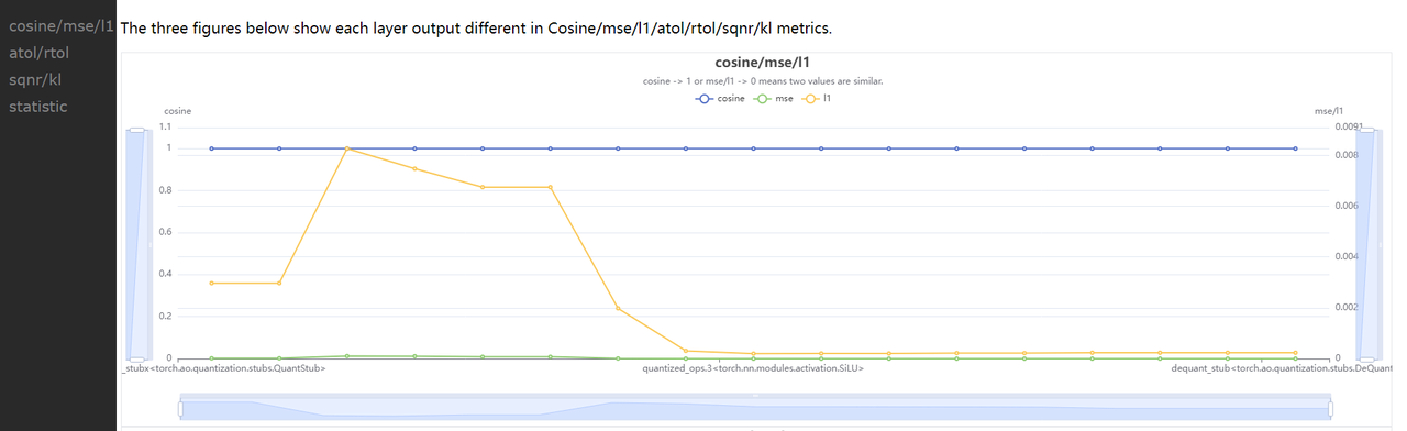

compare_per_layer
    def compare_per_layer(self)
Compare outputs of each layer between the two models.
Output
  • abnormal_layer_advisor.txt: Lists all abnormal layers, including those with low similarity, excessive data range, non-normalized inputs, or lack of high-precision outputs.
  • profiler.html: Visualizes all metric indicators and data range differences per layer.
profiler_html
  • compare_per_layer_out.txt: Tabular display of detailed information for each layer, including various metrics, data ranges, quantization dtypes, etc. Columns from left to right represent:
    • Index: op index
    • mod_name: Name of the op; if it’s a module, shows the prefix name in the model; if a function, left blank
    • base_op_type: Type of the op in the baseline model (module type or function name)
    • analy_op_type: Type of the op in the analysis model
    • Shape: Output shape of the op
    • quant_dtype: Quantization data type of the op output
    • Qscale: Quantization scale of the op output
    • Cosine: Cosine similarity of the op outputs between the two models
    • MSE: MSE distance between the op outputs
    • L1: L1 distance
    • KL: KL divergence
    • SQNR: Signal-to-Quantization-Noise Ratio
    • Atol: Absolute error
    • Rtol: Relative error
    • base_model_min: Minimum value of the op output in the baseline model
    • analy_model_min: Minimum value in the analysis model
    • base_model_max: Maximum value in the baseline model
    • analy_model_max: Maximum value in the analysis model
    • base_model_mean: Mean value in the baseline model
    • analy_model_mean: Mean value in the analysis model
    • base_model_var: Variance in the baseline model
    • analy_model_var: Variance in the analysis model
    |    | mod_name   | base_op_type                                                       | analy_op_type                                                      | shape                      | quant_dtype   |    qscale |    Cosine |       MSE |        L1 |        KL |       SQNR |      Atol |                                            Rtol |   base_model_min |   analy_model_min |   base_model_max |   analy_model_max |   base_model_mean |   analy_model_mean |   base_model_var |   analy_model_var |
    |  0 | quant      | torch.ao.quantization.stubs.QuantStub                              | horizon_plugin_pytorch.nn.qat.stubs.QuantStub                      | torch.Size([1, 3, 32, 32]) | qint8         | 0.0078354 | 0.9999924 | 0.0000052 | 0.0019757 | 0.0000006 | 48.1179886 | 0.0039178 |                                       1.0000000 |        0.0003164 |         0.0000000 |        0.9990171 |         0.9950994 |         0.5015678 |          0.5014852 |        0.0846284 |         0.0846521 |
    |  1 | conv       | torch.nn.modules.conv.Conv2d                                       | horizon_plugin_pytorch.nn.qat.conv2d.Conv2d                        | torch.Size([1, 3, 32, 32]) | qint8         | 0.0060428 | 0.9999037 | 0.0000085 | 0.0023614 | 0.0000012 | 37.1519432 | 0.0096008 |                                      48.2379990 |       -0.7708085 |        -0.7674332 |        0.4674263 |         0.4652941 |        -0.0411330 |         -0.0412943 |        0.0423415 |         0.0422743 |
    |  2 | relu       | torch.nn.modules.activation.ReLU                                   | horizon_plugin_pytorch.nn.qat.relu.ReLU                            | torch.Size([1, 3, 32, 32]) | qint8         | 0.0060428 | 0.9998640 | 0.0000037 | 0.0010231 | 0.0000004 | 35.5429153 | 0.0093980 |                                      48.2379990 |        0.0000000 |         0.0000000 |        0.4674263 |         0.4652941 |         0.0641222 |          0.0639115 |        0.0090316 |         0.0089839 |
    |  3 |            | horizon_plugin_pytorch.nn.interpolate.autocasted_interpolate_outer | horizon_plugin_pytorch.nn.interpolate.autocasted_interpolate_outer | torch.Size([1, 3, 41, 41]) | qint8         | 0.0060428 | 0.9234583 | 0.0012933 | 0.0245362 | 0.0001882 |  8.1621437 | 0.1928777 | 340282346638528859811704183484516925440.0000000 |        0.0000000 |         0.0000000 |        0.3509629 |         0.3504813 |         0.0643483 |          0.0639483 |        0.0043305 |         0.0043366 |
    |  4 | dequant    | torch.ao.quantization.stubs.DeQuantStub                            | horizon_plugin_pytorch.nn.qat.stubs.DeQuantStub                    | torch.Size([1, 3, 41, 41]) | torch.float32 |           | 0.9234583 | 0.0012933 | 0.0245362 | 0.0001882 |  8.1621437 | 0.1928777 | 340282346638528859811704183484516925440.0000000 |        0.0000000 |         0.0000000 |        0.3509629 |         0.3504813 |         0.0643483 |          0.0639483 |        0.0043305 |         0.0043366 |

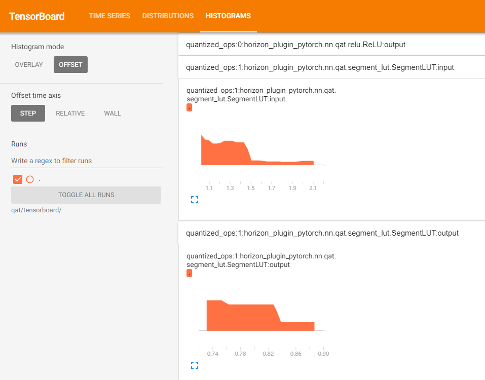

tensorboard
class OpRunningInfoManager:
    def tensorboard(
        self,
        out_dir: str = None,
        prefixes: Tuple[str, ...] = None,
        types: Tuple[Type, ...] = None,
        force_per_channel: bool = False,
Display histograms of input/output for each layer in TensorBoard.
Parameters
  • out_dir: Directory to save TensorBoard files. Default is self.out_dir/tensorboard.
  • prefixes: Prefixes of operators in the model to be profiled. By default, all are included.
  • types: Types of operators in the model to be profiled. By default, all are included.
  • force_per_channel: Whether to display histograms in per-channel quantization mode.
Output
TensorBoard files. Screenshot after opening:
tensorboard
