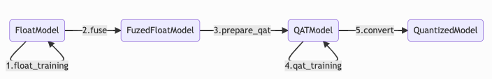

Workflow
The overall workflow for quantization-aware training (QAT) in eager mode is shown in the diagram below:
qat
Construct Floating-Point Model
When constructing the floating-point model in eager mode, please note the following:
  1. Insert quantization and de-quantization nodes into the network. Typically, a quantization node should be inserted at the beginning of the floating-point model, and a de-quantization node at the end. After the floating-point model is converted to a QAT-ready model, the inserted quantization node will perform quantization on the input;
  2. Some function-form floating-point operators need to be replaced with Module-inherited operators from PyTorch or proprietary operators provided by the plugin;
  3. Define fusion functions for floating-point operators to fuse compatible ones.
