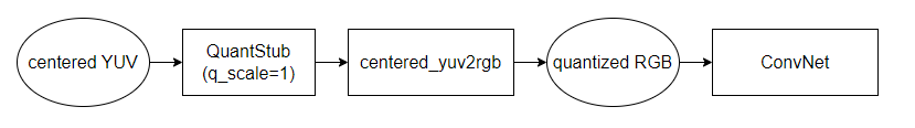

This operator performs the following steps:
  1. Converts the input image to RGB format using the conversion formula corresponding to the specified swing.
  2. Normalizes the RGB image using the given mean and std.
  3. Quantizes the RGB image using the given q_scale.
Since this operator already includes quantization of the RGB image, after inserting it, you must manually change the scale parameter of the model’s QuantStub to 1.
The deployment model with this operator inserted is shown below:
yuv1
This operator is for deployment only. Do not use it during training.

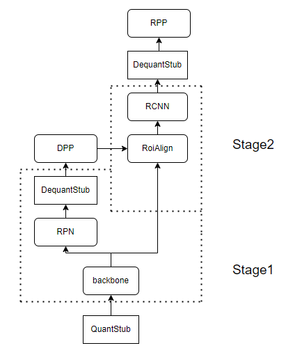

In some scenarios, users may need to deploy a model trained as a single unit in multiple segments. For example, in the two-stage detection model shown below, if DPP needs to run on the CPU and its output (roi) serves as input to RoiAlign, users must split the model into Stage1 and Stage2 according to the dashed-line boundaries for separate compilation and deployment. During hardware execution, the fixed-point data output by the backbone is directly used as input to RoiAlign.
segmented_deploy
Method
segmented_deploy_method

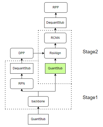

  1. Model modification: As shown above, based on a normally quantization-trainable model, users need to insert a QuantStub after the segmentation boundary before prepare_qat. Note that if using horizon_plugin_pytorch.quantization.QuantStub, the scale must be set to None.
  2. QAT training: Train the modified model as a whole using standard quantization-aware training. The inserted QuantStub records the scale of Stage2 input data in its buffer.
  3. Conversion to fixed-point: Use the convert API to convert the trained QAT model to fixed-point, still treating it as a single unit.
  4. Splitting and compilation: Split the model according to the target hardware layout, then trace and compile each segment separately. Note that although Stage2 input is quantized during training, the example input used when tracing Stage2 must still be in floating-point format. The inserted QuantStub in Stage2 will assign the correct scale and perform quantization.

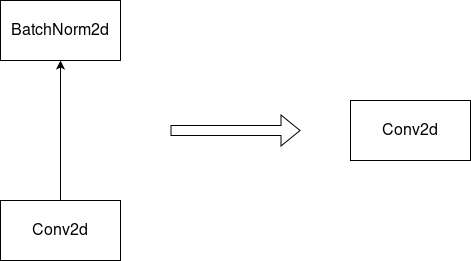

The purpose of absorbing BN is to reduce the model’s computational load. Since BN is a linear transformation, when BN appears together with Conv, the BN parameters can be absorbed into the Conv parameters, thereby eliminating the need to compute BN in the deployed model.
The absorption computation process is as follows:
fuse_bn
By absorbing BN, Conv2d + BN2d can be simplified to Conv2d.

Implementation Principle
Thanks to FX’s ability to access the computation graph, the training tool can automatically analyze the model’s graph, match fusion patterns defined in advance, and perform fusion via submodule replacement. The example below illustrates this.
(BN absorption and Add/ReLU(6) fusion can be achieved using the same mechanism, so no distinction is needed during fusion.)

As seen, after operator fusion, BN is absorbed into Conv, and Conv, Add, and ReLU are fused into a single module (_generated_add_0). The original submodules are replaced with Identity and are no longer invoked in the forward code.
(FX automatically replaces the x = x + y addition in the code with a Module named _generated_add_0 to support fusion and quantization operations.)
