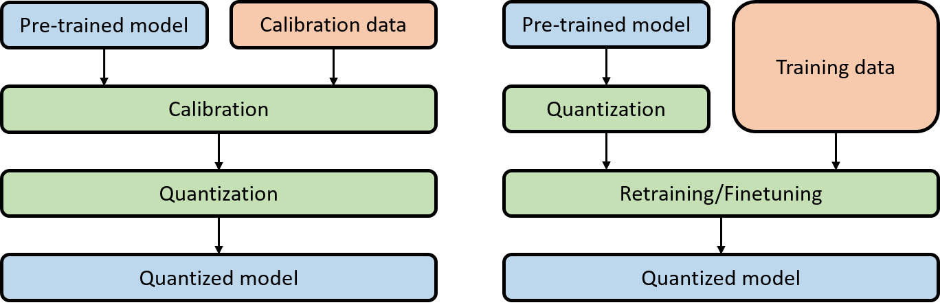

Most models trained on GPUs are floating-point models, meaning their parameters are stored in float type. The BPU (Binary Processing Unit) in the X5 processor uses INT8 computation precision (a common standard across industry processors) and can only run fixed-point quantized models. The process of converting a trained floating-point model into a fixed-point model is called quantization. Depending on whether adjustments are made to the parameters after quantization, we classify quantization methods into QAT (Quantization-Aware Training) and PTQ (Post-Training Quantization). The operational differences between these two methods are illustrated in the figure below (left: PTQ, right: QAT):
qat_ptq_contrast
Post-Training Quantization (PTQ) requires only a small set of calibration data to calibrate the pre-trained floating-point model, directly converting the trained FP32 network into a fixed-point network. This process does not require any retraining of the original floating-point model—only a few hyperparameters are adjusted to complete quantization. It is simple and fast, and has been widely adopted in both edge and cloud scenarios. For more details about the PTQ approach, please refer to the Post-Training Quantization (PTQ) section.
Quantization-Aware Training (QAT) involves retraining the model after quantization. Since fixed-point values cannot be used in backward gradient computation, in practice, fake quantization nodes are inserted before certain operations (OPs) during training to capture the range of data flowing through these OPs. This information is then used during deployment to properly quantize the nodes. We need to iteratively optimize accuracy during training to obtain the best quantization parameters. As this method requires model retraining, it demands higher technical expertise from the operator. For more details about the QAT approach, please refer to the Quantization-Aware Training (QAT) section.

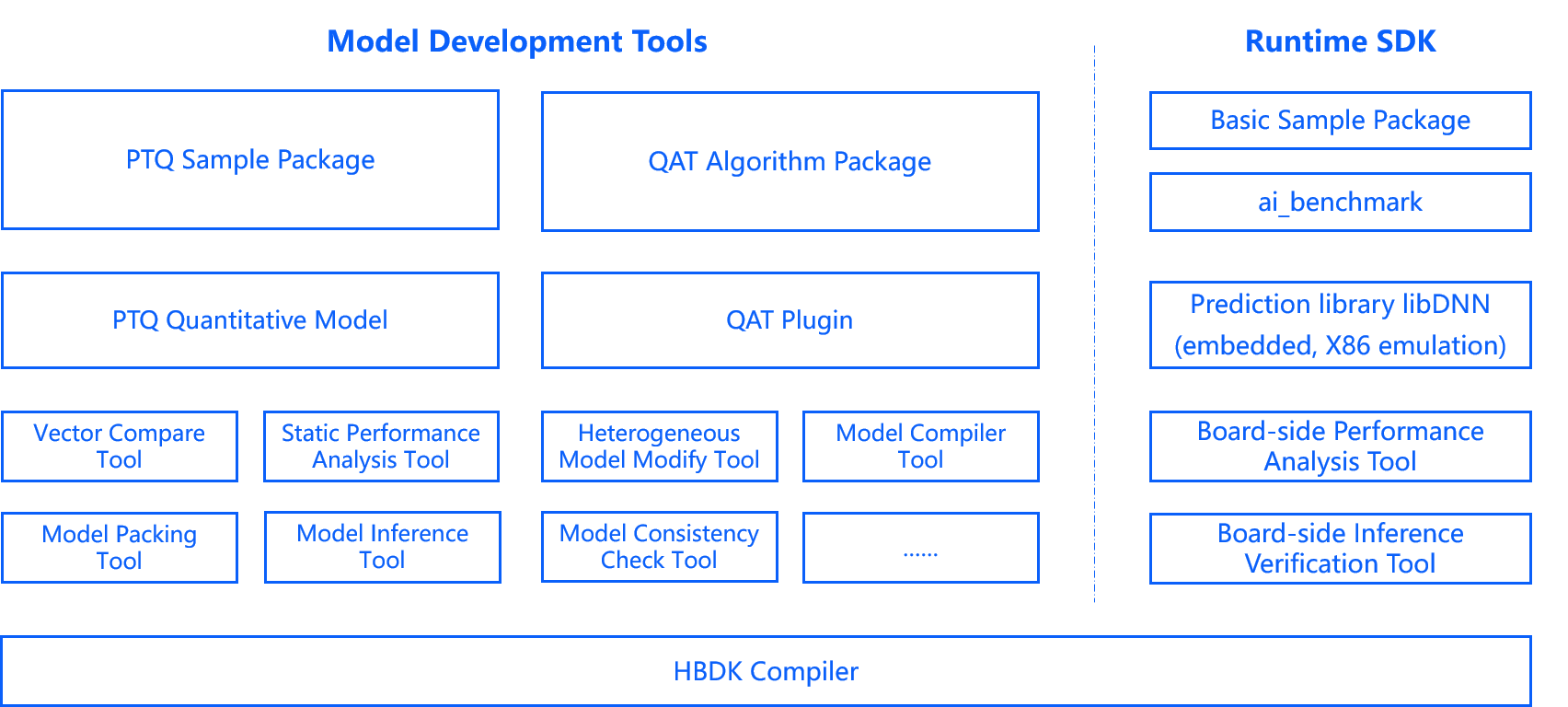

The toolchain consists of PTQ, QAT, and embedded compilation components. The schematic diagram of the toolchain structure is shown below:
