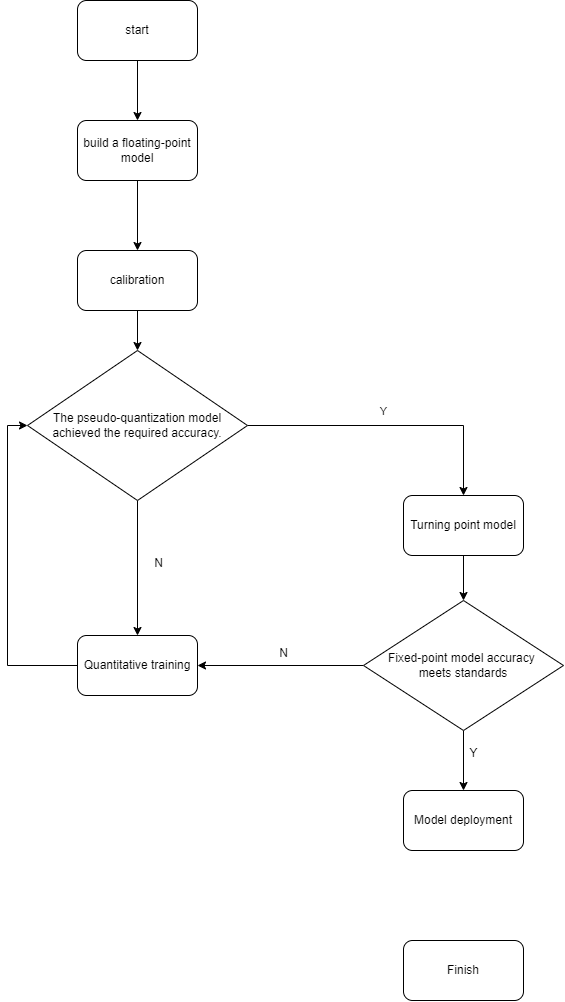

6.4.2.1. Basic Workflow
The basic usage workflow of the quantization training tools is as follows:
quick_start

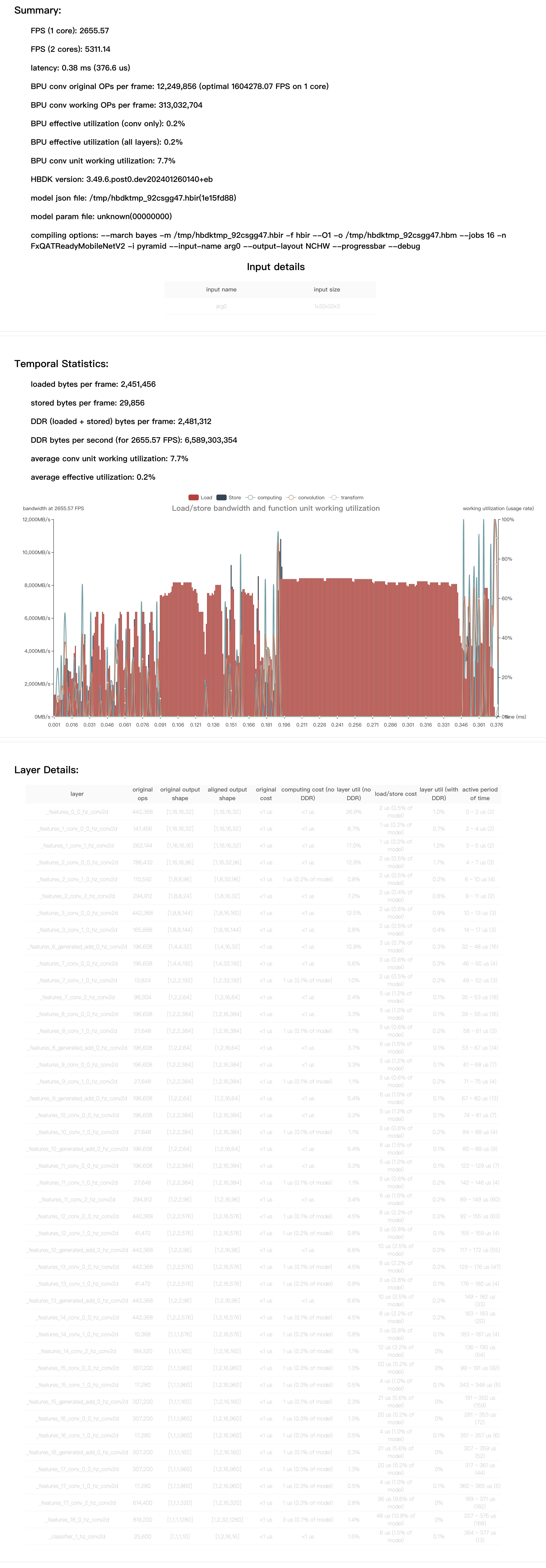

# Performance testing of the model
perf_model(
    script_model,
    [example_input],
    out_dir=os.path.join(model_path, "perf_out"),
    input_source="pyramid",
    opt=compile_opt,
    layer_details=True,
INFO: launch 16 threads for optimization
[==================================================] 100%
WARNING: arg0 can not be assigned to NCHW_NATIVE layout because it's input source is pyramid/resizer.
consumed time 0.587685
HBDK model compilation SUCCESS
    FPS=2655.57, latency = 376.6 us, DDR = 2481312 bytes   (see model/mobilenetv2/perf_out/FxQATReadyMobileNetV2.html)
HBDK performance estimation SUCCESS
As suggested, locate the performance report file. The content is shown below:
