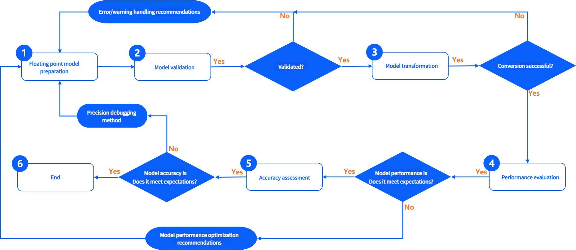

The complete development workflow using the X5 algorithm toolchain involves five key stages: Floating-Point Model Preparation, Model Verification, Model Conversion, Performance Evaluation, and Accuracy Evaluation, as illustrated below:
model_conversion_flowchart
Floating-Point Model Preparation: This stage ensures the original floating-point model is in a format supported by the X5 algorithm toolchain’s model conversion tool. The floating-point model originates from models trained using DL frameworks such as TensorFlow or PyTorch. For detailed requirements and recommendations, please refer to the Floating-Point Model Preparation section.
Model Verification: This stage verifies whether the original floating-point model meets the requirements of the X5 algorithm toolchain. The X5 algorithm toolchain provides the hb_mapper checker tool for checking the floating-point model. For specific usage instructions, please refer to the Verify Model section.
Model Conversion: This stage converts the floating-point model into an X5 mixed heterogeneous model. After this stage, you will obtain a model that can run on the X5 processor. The X5 algorithm toolchain provides the hb_mapper makertbin tool to perform key steps such as model optimization, quantization, and compilation. For specific usage instructions, please refer to the Model Conversion section.
Performance Evaluation: This stage evaluates the inference performance of the X5 mixed heterogeneous model. The X5 algorithm toolchain provides tools for performance evaluation, which you can use to verify whether the model meets application performance requirements. For detailed instructions, please refer to the Model Performance Analysis and Optimization section.
Accuracy Evaluation: This stage evaluates the inference accuracy of the X5 mixed heterogeneous model. The X5 algorithm toolchain provides tools for accuracy evaluation. For detailed instructions, please refer to the Model Accuracy Analysis and Optimization section.

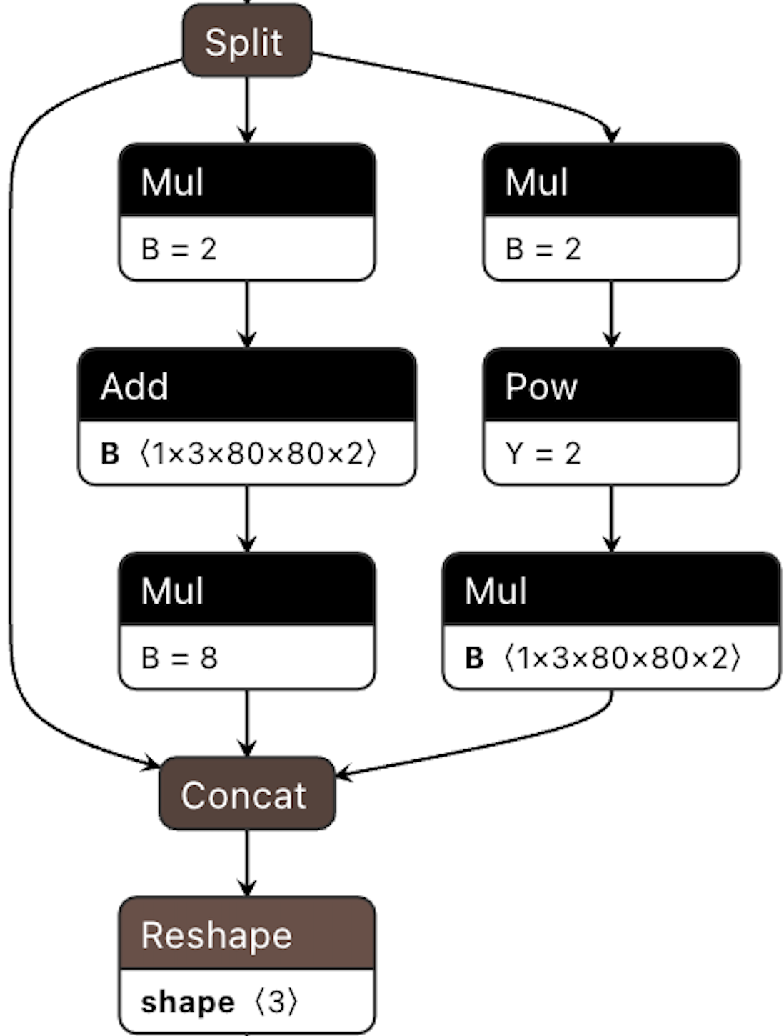

  • The following ONNX model running on X5 contains a Mul + Add + Mul structure. According to the X5 operator constraint list, Mul and Add operators are supported on BPU in five dimensions, provided they meet X5 BPU operator constraints; otherwise, computation falls back to the CPU.
model_reshape
Therefore, the final verification result shows segmentation, as shown below:

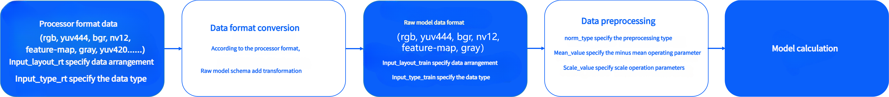

The model conversion stage transforms the floating-point model into an X5 mixed heterogeneous model. After this stage, you will obtain a model that can run on the X5 processor. Before conversion, ensure you have successfully passed the previous model verification step.
Model conversion is performed using the hb_mapper makertbin tool, which completes critical processes such as model optimization and calibration quantization. Calibration requires preparation of calibration data according to the model’s preprocessing requirements. To help you fully understand model conversion, this section will sequentially cover calibration data preparation, tool usage, internal conversion process explanation, result interpretation, and output artifact interpretation.

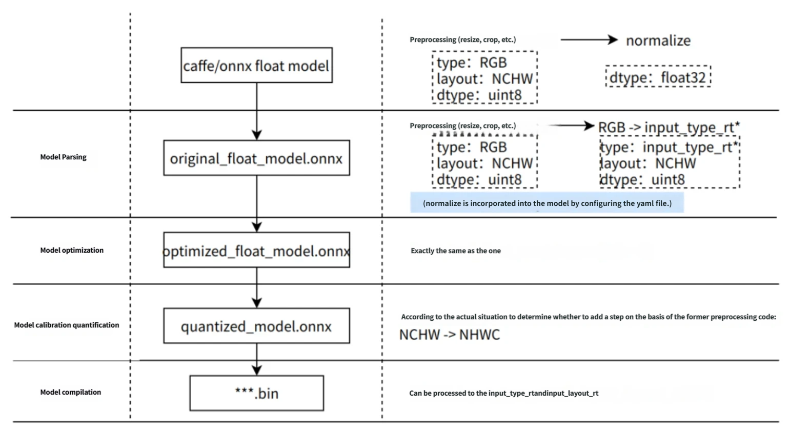

Preparing Calibration Data
During model conversion, the calibration phase requires approximately 100 calibration samples, each as a separate data file. To ensure accuracy after conversion, we recommend that these calibration samples come from your model’s training or validation set, avoiding rare or abnormal samples such as solid-color images or images without any detection or classification targets.
The preprocess_on parameter in the conversion configuration file corresponds to two different preprocessing sample requirements depending on whether it is enabled or disabled. (For detailed parameter configuration, refer to the relevant explanation in the calibration parameter group below.) When preprocess_on is disabled, you must apply the same preprocessing to samples from the training/validation set as done before model inference (inference). The processed calibration samples will have the same data type (input_type_train), dimensions (input_shape), and layout (input_layout_train) as the original model. For models with featuremap inputs, you can use the numpy.tofile command to save the data as a float32 binary file. The toolchain will read the data during calibration using the numpy.fromfile command. For example, an original floating-point classification model trained on ImageNet has only one input node, with input specifications as follows:
  • Input type: BGR
  • Input layout: NCHW
  • Input dimensions: 1x3x224x224
Data preprocessing when using the validation set for model inference (inference) includes:
  1. Scale image proportionally so the shorter side is 256.
  2. Use the center_crop method to extract a 224x224 image.
  3. Subtract mean per channel.
  4. Multiply data by a scale factor.
Sample processing code for the above example model:
To avoid excessive code length, simple transformer implementation code is not included. For specific usage, please refer to the Transformer Usage Guide section.
Tip:
  • It is recommended to refer to preprocessing methods in the horizon_model_convert_sample example package of the X5 algorithm toolchain, such as 02_preprocess.sh and preprocess.py for Caffe and ONNX example models.
# This example uses skimage; OpenCV usage may differ
# Note: The transformers below do not include mean subtraction or scaling
# Mean and scale operations are fused into the model; refer to norm_type/mean_value/scale_value configuration below
def data_transformer():
    transformers = [
    # Scale proportionally, short side to 256
    ShortSideResizeTransformer(short_size=256),
    # CenterCrop to get 224x224 image
    CenterCropTransformer(crop_size=224),
    # skimage reads as NHWC, convert to NCHW required by model
    HWC2CHWTransformer(),
    # skimage reads RGB, convert to BGR required by model
    RGB2BGRTransformer(),
    # skimage values in [0.0,1.0], adjust to model's required range
    ScaleTransformer(scale_value=255)
    return transformers
# src_image: original image from calibration set
# dst_file: filename for storing final calibration data
def convert_image(src_image, dst_file, transformers):
    image = skimage.img_as_float(skimage.io.imread(src_image))
    for trans in transformers:
        image = trans(image)
    # Model specifies input_type_train BGR as UINT8
    image = image.astype(np.uint8)
    # Save calibration sample as binary data file
    image.tofile(dst_file)
if __name__ == '__main__':
    # Pseudocode: collection of original calibration images
    src_images = ['ILSVRC2012_val_00000001.JPEG', ...]
    # Pseudocode: final calibration filenames (extension not restricted)
    # calibration_data_bgr_f32 is the cal_data_dir specified in your config file
    dst_files = ['./calibration_data_bgr_f32/ILSVRC2012_val_00000001.bgr', ...]
    transformers = data_transformer()
    for src_image, dst_file in zip(src_images, dst_files):
Tip:
  • When preprocess_on is enabled, calibration samples can be image files in formats supported by skimage.
  • The conversion tool reads these images and resizes them to the size required by the model’s input node, using the result as calibration input.
  • This approach is simpler but does not guarantee quantization accuracy. Therefore, we strongly recommend using the disabled preprocess_on method.

The model conversion stage completes the conversion of floating-point model to X5 hybrid heterogeneous model. In order to enable this heterogeneous model to run quickly and efficiently on the embedded end, the focus of model conversion is to solve the two problems of input data processingand model optimization and compilation. This section will focus on these two key problems in turn. Input Data ProcessingThe X5 processor will provide hardware-level support solutions for certain specific types of model input paths. For example: the video processing subsystem in the video path provides image cropping, scaling and other image quality optimization functions for image acquisition. The output of these subsystems is YUV420 NV12 format images. Algorithm models are often trained based on commonly used image formats such as bgr/rgb.
The solutions provided for this situation are:
  • Each transformed model provides two descriptions, one for describing the input data of the original floating-point model ( input_type_train and input_layout_train ), and the other for describing the input data of the processor we need to dock ( input_type_rt and input_layout_rt ).
  • Mean/scale of image data is also a relatively common operation, but the data format supported by processors such as YUV420 NV12 is not suitable for such operations. Therefore, we have also solidified these common image preprocessing into the model.
After processing the above two methods, the input part of the ***.bin heterogeneous model produced in the model conversion stage will become the state as shown below.
input_data_process
The data layout in the above figure only has two data layout formats: NCHW and NHWC. N represents quantity, C represents channel, H represents height, W represents width. The two different arrangements reflect different memory access characteristics. NHWC is commonly used in TensorFlow model, and NCHW is used in Caffe. The X5 processor will not limit the data layout used, but there are two requirements: the first is that the input_layout_train must be consistent with the data layout of the original model; the second is to prepare data arranged consistently with the input_layout_rt on the processor. Correct data layout is the basis for smooth analysis of data.
The model conversion tool will automatically add data conversion nodes according to the data format specified by input_type_rt and input_type_train. Based on previous practical experience, Not any type combination is required. In order to avoid misuse, we only open some fixed type combinations, as shown in the table:

  • input_type_rt* represents the intermediate format of input_type_rt.
  • Please use the visualization tool Netron to view the `quantized_model.onnxdata layout of the input nodes to decide whether to addlayout conversion`` to preprocessing.
Model analysis phaseFor Caffe floating point model, the conversion to the ONNX floating point model will be completed. On the original floating-point model, whether to join the data preprocessing node will be determined based on the configuration parameters in the transformation configuration yaml file. In this stage, an original_float_model.onnx is produced. The calculation accuracy of this ONNX model is still float32, but a data preprocessing node is added to the input part.
Ideally, this preprocessing node should complete the complete conversion of input_type_rt to input_type_train, The actual situation is that the entire type conversion process will be completed with the X5 processor hardware, and the ONNX model does not contain the hardware conversion part. Therefore, the real input type of ONNX will use an intermediate type, which is the hardware processing result type for input_type_rt. The data layout (NCHW/NHWC) will keep the input layout of the original floating point model consistent. Each type of input_type_rt has a specific corresponding intermediate type, as shown in the table:
nv12 yuv444 rgb bgr gray featuremap
yuv444_128 yuv444_128 RGB_128 BGR_128 GRAY_128 featuremap
Remark:
The bold part of the first row in the table is the data type specified by input_type_rt, and the second row is the intermediate type corresponding to the specific input_type_rt. This intermediate type is the input type of original_float_model.onnx. Each type is explained as follows:
  • yuv444_128 is the result of yuv444 data minus 128, and each value is expressed by int8.
  • RGB_128 is the result of minus 128 of RGB data, and each value is expressed by int8.
  • BGR_128 is the result of minus 128 of BGR data, and each value is expressed by int8.
  • GRAY_128 is the result of minus 128 of gray data, and each value is expressed by int8.
  • featuremap is a four-dimensional tensor data, each value is represented by float32.
Model Optimization PhaseImplement some operator optimization strategies for the model that are suitable for the X5 platform, such as BN fusion to Conv, etc. The output of this stage is an optimized_float_model.onnx. The calculation accuracy of this ONNX model is still float32, and it will not affect the calculation results of the model after optimization. The input data requirements of the model are still consistent with the previous original_float_model.
Model Calibration PhaseThe calibration data you provide will be used to calculate the necessary quantization threshold parameters. These parameters will be entered directly into the quantization phase without generating a new model state. Model Quantization PhaseModel quantization is completed using the parameters obtained by calibration, and the output of this phase is a quantized_model.onnx. The calculation accuracy of this model is already int8. Using this model, you can evaluate the accuracy loss caused by model quantization. This model requires that the input basic data format and layout are still the same as original_float_model, but layout and numerical representation have changed. The overall changes compared to the original_float_model input are described as follows:
  • When the value of input_type_rt is not featuremap, all input data types are INT8. On the contrary, when the value of input_type_rt is featuremap, the input data type is float32.
  • The data layout layout relationship is: input_layout_train and the layout inputs of origin.onnx, calibrated_model.onnx, quanti.onnx are consistent with the layout inputs of the original model.
Notice: If input_type_rt is nv12, the corresponding input layout of quanti.onnx is NHWC.

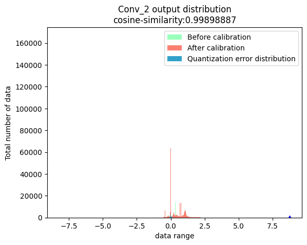

Similarity information also exists in the console output content of makertbin. Before the makertbin status information, its content form is as follows:
  Node ON Subgraph Type Cosine Similarity Threshold
  ... ... ... 0.999936 127.000000
  ... ... ... 0.999868 2.557209
  ... ... ... 0.999268 2.133924
  ... ... ... 0.996023 3.251645
... ... ... 0.996656 4.495638
Among the output content listed above:
  • The interpretations of Node, ON, Subgraph, Type and the hb_mapper checker tool are consistent. Please refer to the previous article Interpretation of Check Results;
  • Threshold is the calibration threshold for each level, which is used to feedback information to technical support in abnormal states, and does not require attention in normal conditions;
  • Cosine Similarity column reflects the cosine similarity between the original floating-point model of the corresponding operator in the Node column and the output results of the quantized model.
Tips:
In general, a model output node with Cosine Similarity >= 0.99 indicates normal quantization of the model. If the cosine similarity at the output node is below 0.8, noticeable accuracy degradation may occur. Note that Cosine Similarity is only a reference indicator for data stability after quantization and does not directly correlate with model accuracy.
For fully accurate accuracy assessment, please refer to the section Model Accuracy Analysis and Optimization.

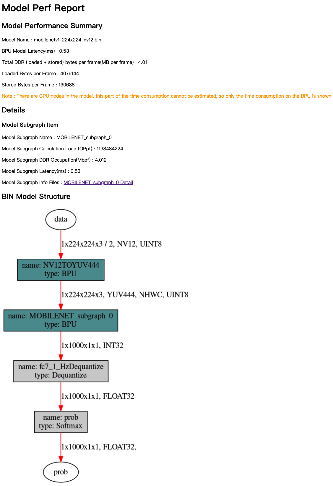

Open mobilenetv1_224x224_nv12.html in a browser. The content appears as follows:
hb_mapper_perf_2
The analysis results consist of three main parts: Model Performance Summary, Details, and BIN Model Structure.
Model Performance Summary provides an overall performance evaluation of the bin model, with the following metrics:
  • Model Name — Name of the model.
  • Model Latency(ms) — End-to-end inference latency per frame (in milliseconds).
  • Total DDR (loaded+stored) bytes per frame(MB per frame) — Total DDR usage per frame for BPU data loading and storage (in MB/frame).
  • Loaded Bytes per Frame — Data read per frame during model execution.
  • Stored Bytes per Frame — Data written per frame during model execution.
The BIN Model Structure section provides a subgraph-level visualization of the bin model. Dark cyan nodes represent operations running on the BPU, while gray nodes represent CPU computations.

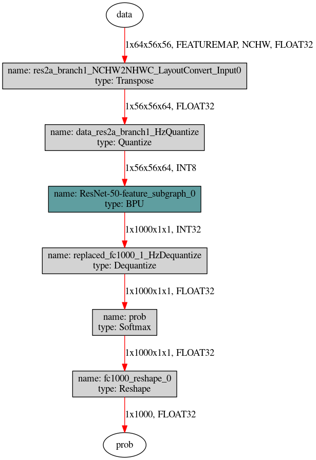

When reviewing Details and BIN Model Structure, you should understand the concept of subgraphs.
If the model contains operators designated for CPU execution, the model conversion tool splits the BPU-computable segments before and after the CPU operator into two independent subgraphs.
For more details, refer to the Model Validation section.

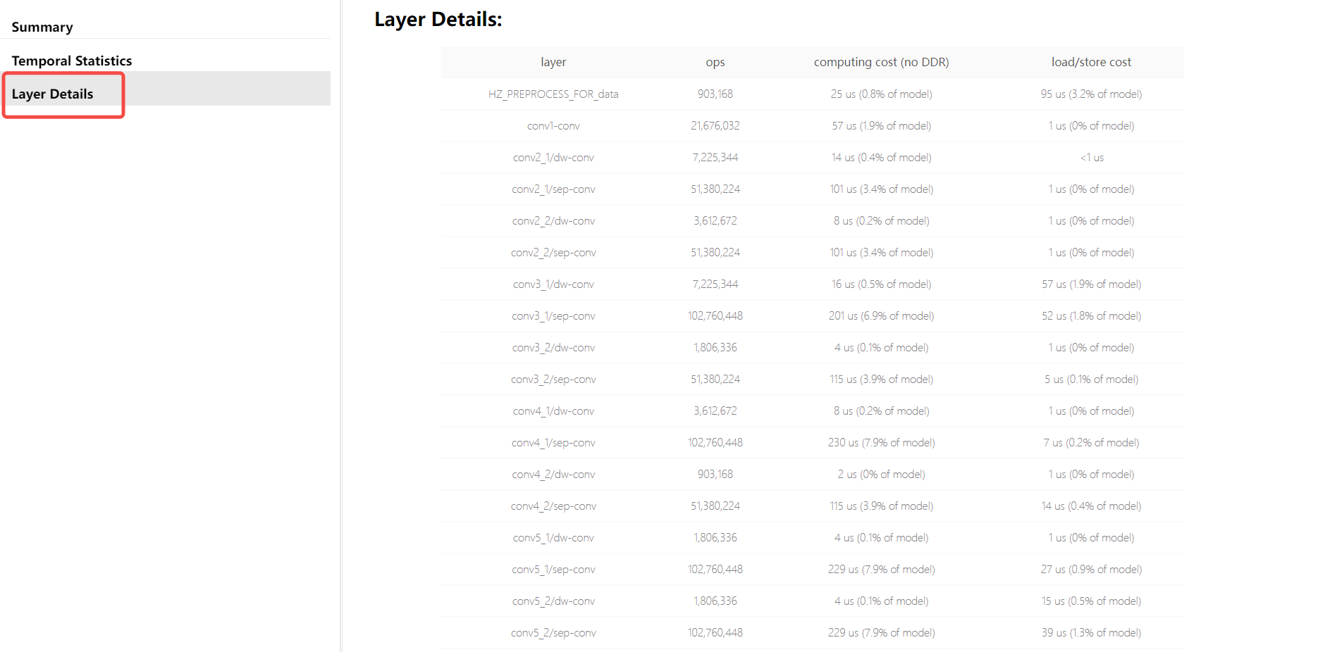

Layer Details provide operator-level analysis and can be used as a reference during model debugging and analysis. For example, if certain BPU operators cause poor performance, the analysis results can help pinpoint the specific operators.
layer_details
Each metric is interpreted as follows:
  • layer — Name of the layer.
  • ops — Computation load.
  • original output shape — Original operator output shape.
  • aligned output shape — Aligned operator output shape.
  • computing cost (no DDR) — Computation time.
  • load/store cost — Data transfer time.
  • active period of time — Active time period of the layer after compilation (does not represent actual execution time, often involving alternating/parallel execution of multiple layers).
Note:

The above log corresponds to the BIN Model Structure section described in Performance Estimation Using hb_perf Tool.
Each node in the visualization has a corresponding entry in the profiler.log file, identifiable by name. Additionally, the profiler.log file records execution times for each node, providing references for optimizing model operators. Since BPU nodes have special requirements for input/output (e.g., specific layout and padding alignment), preprocessing of input and output data is required.
  • Preprocess: Represents padding and layout conversion operations on model input data; timing is recorded under Preprocess.
  • xxxx_input_layout_convert: Represents padding and layout conversion on BPU node input data; timing is recorded under xxxx_input_layout_convert.
  • xxxx_output_layout_convert: Represents removal of padding and layout conversion on BPU node output data; timing is recorded under xxxx_output_layout_convert.

    • For models like the one below where nodes are not directly connected to input/output, use the hb_model_modifier tool to check whether connected nodes can be removed and delete them sequentially.

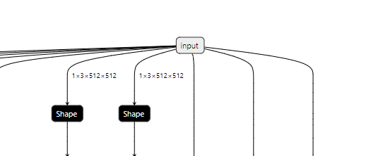

      nodes_connected
      First use the hb_perf tool to get the model structure diagram, then use the following two commands to remove the Quantize node top-down.
      For Dequantize nodes, remove them bottom-up. The names of removable nodes at each step can be viewed via hb_model_modifier x.bin.
        hb_model_modifier x.bin -r res2a_branch1_NCHW2NHWC_LayoutConvert_Input0
        hb_model_modifier x_modified.bin -r data_res2a_branch1_HzQuantize

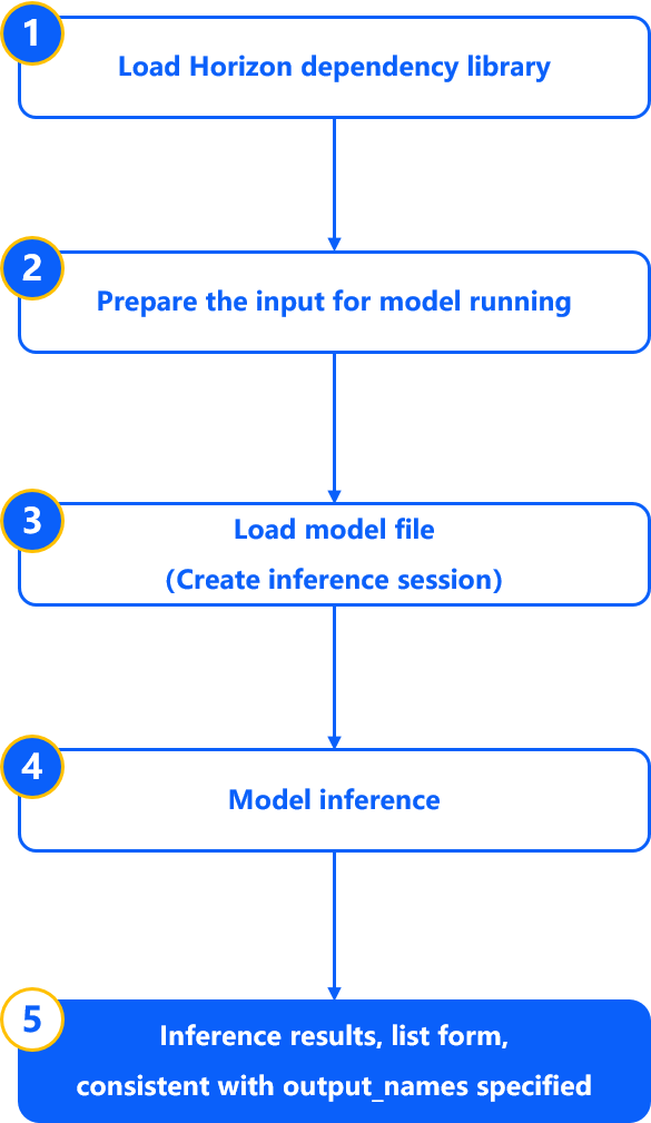

We recommend using the X5 SDK to load the ONNX model for inference. The basic process is as follows:
Note:
  1. The example code applies not only to quantized models but also to original and optimized models. Prepare data according to the input type and layout requirements of different models for inference.
  2. We recommend referring to the accuracy validation methods for example models (Caffe, ONNX, etc.) in the horizon_model_convert_sample example package of the X5 algorithm toolchain: 04_inference.sh and postprocess.py.
import numpy as np
# Load D-Robotics dependency library
# Prepare model input
input_data = np.load("input.npy")
# Load model file
sess = HB_ONNXRuntime(model_file = "***_quantized_model.onnx")
# Get model input & output node information
input_names = sess.input_names
output_names = sess.output_names
# Prepare input data (assuming the model has only one input)
input_info = {input_names[0]: input_data}
# Start inference; output is a list corresponding to output_names
output = sess.run(output_names, input_info)
Additionally, input data preparation is the most error-prone step. Compared to the accuracy validation process during original floating-point model design & training, we recommend adjusting the inference input data after preprocessing: mainly data format (RGB, NV12, etc.), data precision (int8, float32, etc.), and data layout (NCHW or NHWC).
The adjustment method is determined by the four parameters input_type_train, input_layout_train, input_type_rt, and input_layout_rt set in the YAML configuration file during model conversion. For detailed rules, refer to the Interpretation of Internal Conversion Process section.
For example, consider an original floating-point classification model trained on ImageNet with a single input node accepting three-channel images in BGR order with NCHW layout.
During the original floating-point model design & training phase, the data preprocessing before inference on the validation set includes:
  1. Resize image proportionally so the shorter side is 256.
  2. Use center_crop to obtain a 224x224 image.
  4. Multiply data by scale factor.
When converting this original floating-point model using the X5 algorithm toolchain,
set input_type_train to bgr, input_layout_train to NCHW, input_type_rt to bgr,
and input_layout_rt to NHWC.
According to the rules described in Interpretation of Internal Conversion Process, ***_quantized_model.onnx expects input in bgr_128 format with NHWC layout.
Corresponding to the example code above, the data preparation process in your_custom_data_prepare should be:
  # This example uses skimage; OpenCV would differ
  # Note: Transformers do not include mean subtraction or scaling
  # Mean and scale operations are fused into the model; see norm_type/mean_value/scale_value configuration earlier
def your_custom_data_prepare_sample(image_file):
    # skimage reads image in NHWC layout
    image = skimage.img_as_float(skimage.io.imread(image_file))
    # Resize proportionally, short side to 256
    image = ShortSideResize(image, short_size=256)
    # CenterCrop to 224x224
    image = CenterCrop(image, crop_size=224)
    # skimage reads RGB; convert to BGR for bgr_128
    image = RGB2BGR(image)
    # If original model uses NCHW input (except when input_type_rt is nv12)
    if layout == "NCHW":
      image = HWC2CHW(image)
    # skimage values in [0.0,1.0]; scale to bgr range
    image = image * 255
    # bgr_128 is bgr minus 128
    image = image - 128
    # bgr_128 uses int8
    image = image.astype(np.int8)
    return image

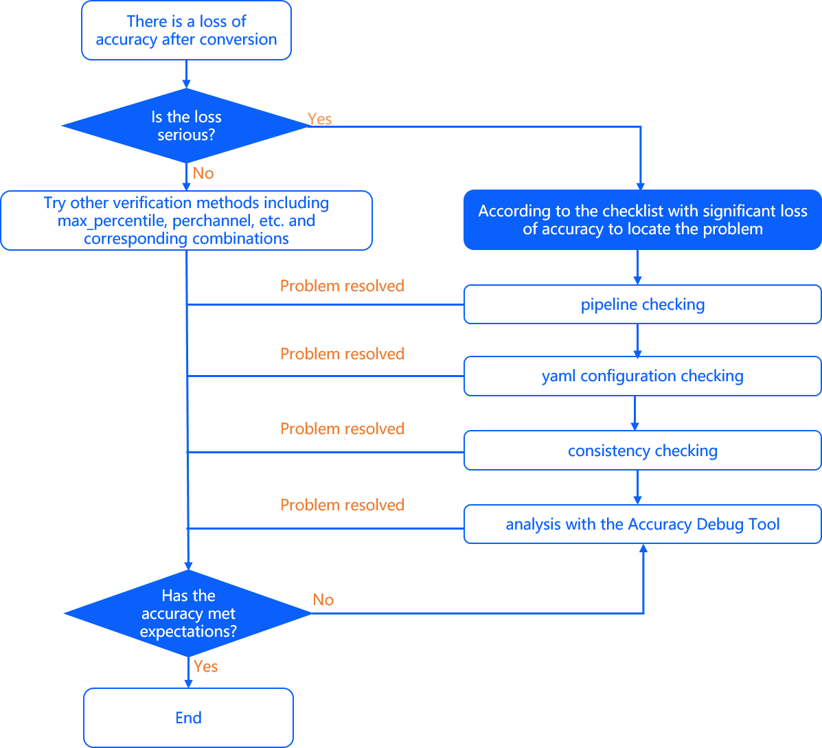

Based on the accuracy analysis above, if quantization accuracy does not meet expectations, resolve according to the following two scenarios:
  1. Significant accuracy loss (greater than 4%).
    This is often caused by improper YAML configuration or imbalanced calibration datasets. We recommend checking the suggestions below one by one.
  2. Minor accuracy loss (1.5%~3%).
    After ruling out issues from case 1, if there is still minor accuracy degradation, it is likely due to model sensitivity. We recommend using the accuracy optimization tools provided by the X5 algorithm toolchain.
  3. If accuracy remains unsatisfactory after trying cases 1 and 2, try using our provided accuracy debug tools for further investigation.
The overall accuracy issue resolution process is illustrated below:
accuracy_problem
Significant Accuracy Loss (Over 4%)
If the model accuracy loss exceeds 4%, it is typically caused by improper YAML configuration, imbalanced validation datasets, etc. It is recommended to troubleshoot step by step from the following aspects: pipeline, model conversion configuration, and consistency checks.
Pipeline Inspection:
The pipeline refers to your complete process of data preprocessing, model conversion, model inference, post-processing, and accuracy evaluation. Please verify each of these steps according to the corresponding sections above.
Based on past issue-tracking experiences, we find that in most cases, changes made during the original floating-point model training phase were not timely reflected in the model conversion step, leading to abnormal accuracy validation results.
Model Conversion YAML Configuration Check:
According to the recommended workflow for PTQ accuracy evaluation and consistency verification, if the accuracy issue is traced back to original_float.onnx, we recommend carefully reviewing the YAML configuration file and preprocessing/postprocessing code for errors. Common pitfalls in the YAML configuration include:

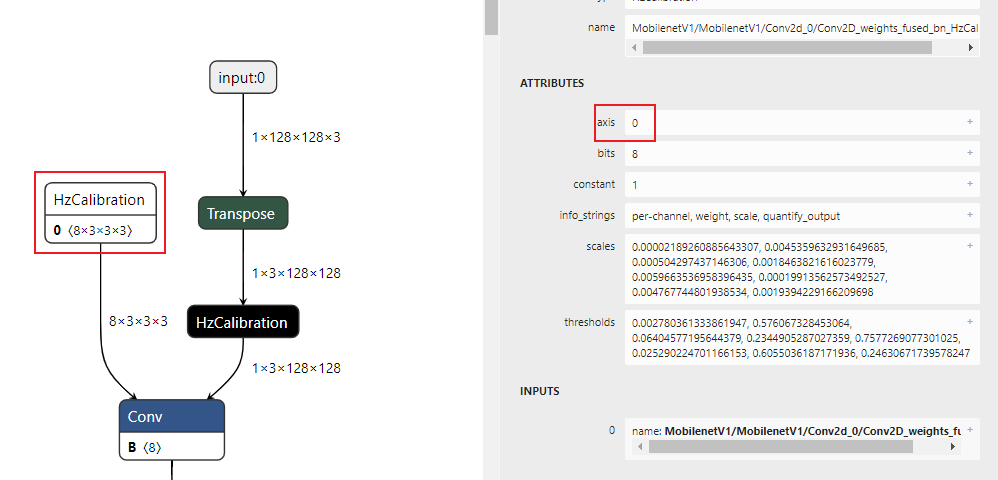

  • input_type_rt and input_type_train: These parameters differentiate the data format required by the mixed heterogeneous model after conversion and the original floating-point model. Ensure they are correctly set, especially regarding BGR and RGB channel order.
  • Correctness of parameters such as norm_type, mean_value, and scale_value. These configurations can directly insert mean and scale operation nodes into the model. Confirm whether the validation/test images undergo duplicate mean and scale operations—repeated preprocessing is a common source of errors.
Data Processing Consistency Check:
  • Incorrectly specifying read_mode: In 02_preprocess.sh, the image reading mode can be set via the --read_mode parameter, supporting opencv and skimage.
    Additionally, preprocess.py also sets the image reading mode via the imread_mode parameter, which should be modified accordingly. Using skimage for image loading results in RGB channel order, value range 0~1, and data type float; whereas using opencv yields BGR channel order, value range 0~255, and data type uint8.
  • Incorrect storage format of calibration dataset: Currently, X5 uses numpy.tofile to save calibration data, which does not preserve shape or data type information. During loading, these must be manually specified. Ensure consistency in data type, dimensions, and layout during serialization and deserialization. If input_type_train is in non-featuremap format, the data dtype is determined by whether the calibration data path contains “f32”: if so, data is parsed as float32; otherwise, as uint8.
  • Inconsistency in transformer implementation: We provide a series of common preprocessing functions located in /horizon_model_convert_sample/01_common/python/data/transformer.py. Implementation differences in certain preprocessing operations may exist. For example, ResizeTransformer uses OpenCV’s default interpolation method (linear). If a different interpolation method is used, modify the source code in transformer.py to ensure consistency with the training preprocessing code. Refer to the transformer usage guide section for details.
  • During the X5 algorithm toolchain usage, continue using the same data processing libraries relied upon during original floating-point model training and validation.
    For models with poor robustness, differences in implementations of typical operations (e.g., resize, crop) across libraries may introduce disturbances that affect model accuracy.
  • Proper setup of the validation image set: The calibration dataset should contain approximately one hundred images, ideally covering various data distribution scenarios. For multi-task or multi-class models, ensure the validation set covers all prediction branches or categories.
    Avoid anomalous images that deviate from the data distribution (e.g., overexposed images).
  • Re-validate accuracy using ***_original_float_model.onnx. Under normal circumstances, the accuracy of this model should align with the original floating-point model up to three to five decimal places.
    If this level of alignment is not achieved, further inspect your data processing pipeline.

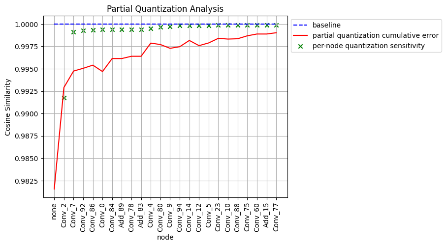

Accuracy Debug Tool
After trying the above two accuracy optimization methods, if accuracy still does not meet expectations, you may use our accuracy debug tool.

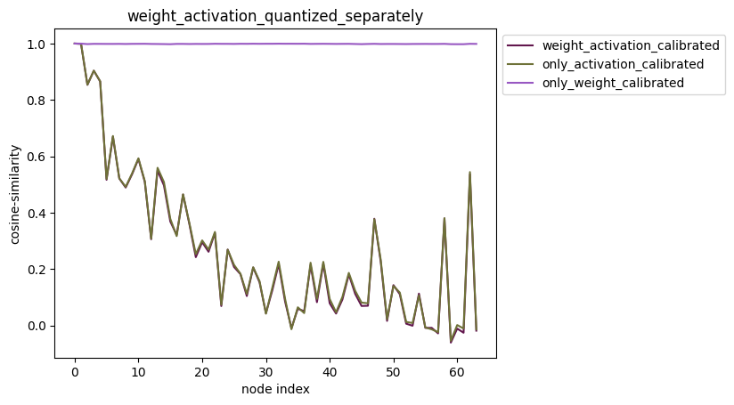

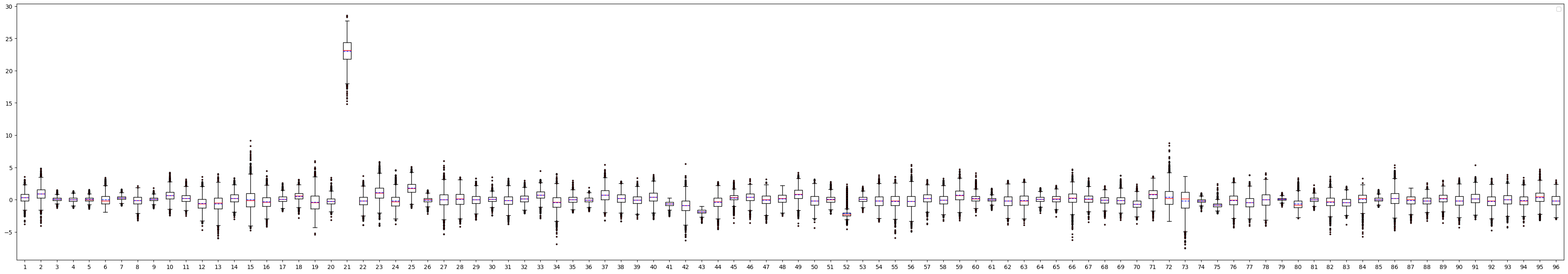

During the PTQ post-quantization process, accuracy loss mainly stems from two causes: sensitive node quantization issues and accumulated quantization error across nodes.
To help you locate these issues, we provide an accuracy debug tool to assist in autonomously identifying accuracy problems during model quantization.
This tool enables node-level quantization error analysis on the calibrated model, helping you quickly identify nodes with abnormal accuracy degradation.

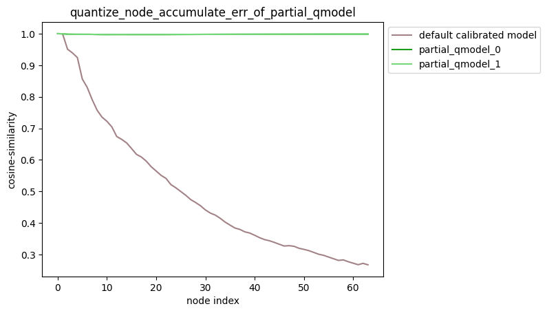

If you are using the X5 product, you may also try configuring certain ops to compute in int16 for accuracy tuning:
During model conversion, most ops default to int8 computation. In some scenarios, using int8 for certain ops may lead to significant accuracy loss.
For the X5 product, the current algorithm toolchain supports specifying certain ops to compute in int16. For details, refer to the int16 configuration guide.
By configuring accuracy-sensitive ops (based on cosine similarity) to compute in int16, accuracy loss can be mitigated in certain scenarios.

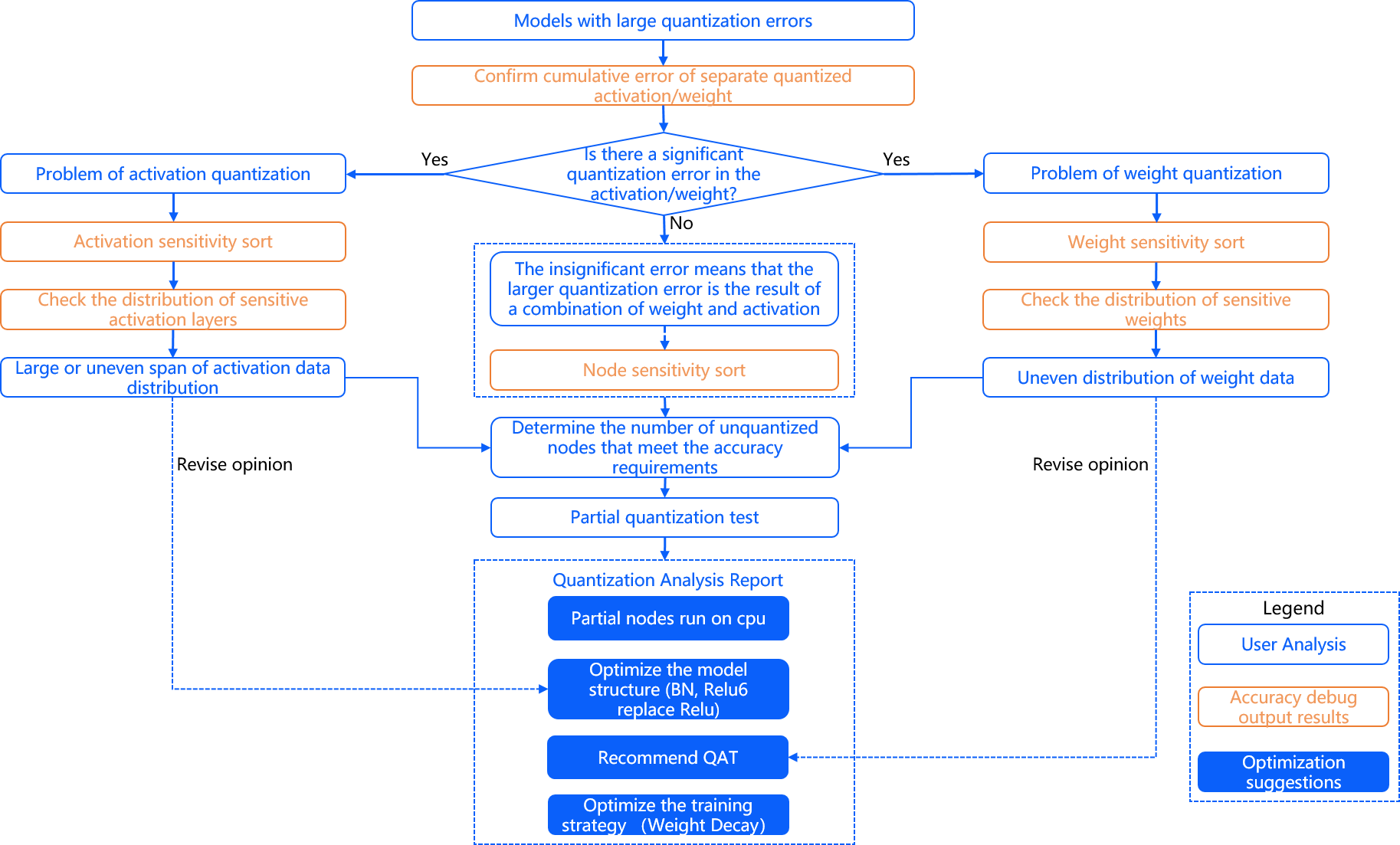

The algorithm toolchain calibrates and quantizes the model using your provided calibration samples to ensure efficient deployment on the X5 computing platform. However, during the conversion process, accuracy loss is inevitably introduced due to the transition from floating-point to fixed-point arithmetic. The main reasons for accuracy loss typically include:

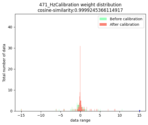

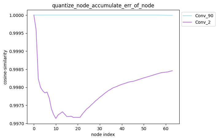

  1. Certain nodes in the model are highly sensitive to quantization, introducing large errors—this is known as the sensitive node quantization issue.
  2. Accumulated errors across nodes lead to significant overall calibration error, including: accumulated error from weight quantization, activation quantization, and full-model quantization.

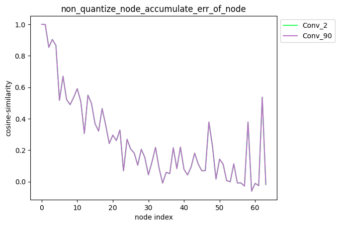

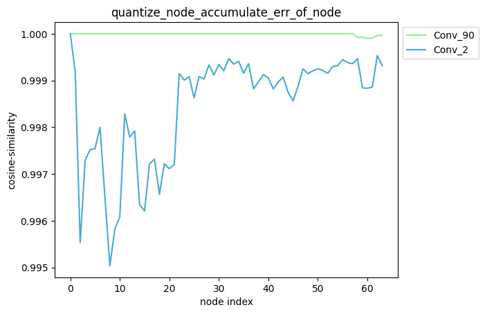

To address this, the X5 algorithm toolchain provides an accuracy debug tool to help you autonomously locate accuracy issues during model quantization.
This tool enables node-level quantization error analysis on the calibrated model, helping you quickly identify nodes with abnormal accuracy.
The accuracy debug tool offers multiple analysis functions, such as:

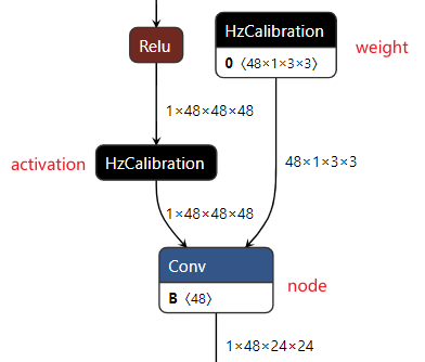

Understanding the Calibrated Model (calibrated_model.onnx)
The calibrated model is an intermediate artifact produced by the model conversion toolchain after structural optimization of the floating-point model and computation of quantization parameters for each node using calibration data.
Its key feature is the presence of calibration nodes of type HzCalibration, which fall into two categories: activation calibration nodes and weight calibration nodes.
  • Activation calibration nodes: Their input is the output of the preceding node. They quantize and dequantize the input using stored quantization parameters (scales and thresholds) before outputting.
  • Weight calibration nodes: Their input is the original floating-point weights. They quantize and dequantize the weights using stored quantization parameters before outputting.
Other nodes in the calibrated model are referred to by the accuracy debug tool as ordinary nodes (node), including types such as Conv, Mul, Add, etc.
debug_node

Analysis Result Display:
Description: First, set the node type via node_type. The tool retrieves all nodes of that type and computes their quantization sensitivity. When verbose=True, results are printed and sorted—higher error nodes appear first.
Sample output when verbose=True:
=================node sensitivity=================
node                  cosine-similarity  mse
Conv_60               0.77795            68.02103
Conv_48               0.78428            64.36318
Where:
  • node: Node name.
  • cosine-similarity, mse: Quantization sensitivity values.
When verbose=True and node_type='weight':
====================================node sensitivity====================================
weight                                              node     cosine-similarity  mse
471_HzCalibration                                   Conv_2   0.99978            0.07519
Where:
  • weight: Weight calibration node name.
  • node: Corresponding ordinary node name (output of the weight calibration node).
  • cosine-similarity, mse: Sensitivity values.
When verbose=True and node_type='activation':
activation          node                  threshold  bit  cosine-similarity  mse
406_HzCalibration   Conv_60               0.91501    8    0.77851            67.82422
Where:
  • activation: Activation calibration node name.
  • node: Following ordinary node in model (input to the activation calibration node).
  • threshold: Calibration threshold (maximum if multiple).
  • bit: Quantization bit width.

Function: Quantize only one node in the floating-point model and compute the error between its output and the original model’s output, generating a cumulative error curve.
Command-line Format:
hmct-debugger plot-acc-error MODEL_OR_FILE CALIBRATION_DATA --other options
Use hmct-debugger plot-acc-error -h/--help to view parameters.
Parameter Group:
Parameter Name Parameter Description Value Range Required/Optional
save_dir or -s Purpose: Save directory.
Description: Optional. Specifies where to save results.
Range: None.
Default: None.
Optional
calibrated_data Purpose: Specify calibration data.
Description: Required. Specifies the calibration data for analysis.
Range: None.
Default: None.
Required
model_or_file Purpose: Specify calibrated model.
Description: Required. Specifies the model to analyze.
Range: None.
Default: None.
Required
quantize_node or -q Purpose: Quantize only specified nodes to view error accumulation.
Description: Optional. Specifies nodes to quantize, keeping others unquantized.
Nested list determines single or partial quantization.
Examples:
- ['Conv_2','Conv_9']: Quantize each separately.
- [['Conv_2'],['Conv_9','Conv_2']]: Quantize Conv_2 alone, then both.
Special values:
- ['weight']: Quantize only weights.
- ['activation']: Quantize only activations.
- ['weight','activation']: Quantize weights and activations separately.
Note: quantize_node and non_quantize_node cannot both be None.
Range: All nodes in calibrated model.
Default: None.
Optional
non_quantize_node or -nq Purpose: Specify node(s) to exclude from quantization.
Description: Optional. Nodes not to quantize; all others will be quantized.
Nested list determines single or partial exclusion.
Example: ['Conv_2','Conv_9']: Dequantize each separately.
Note: One of quantize_node or non_quantize_node must be specified.
Default: None.
Optional
metric or -m Purpose: Error metric.
Description: Method to compute model error.
Range: 'cosine-similarity', 'mse', 'mre', 'sqnr', 'chebyshev'
Default: 'cosine-similarity'.
Optional
average_mode or -a Purpose: Output mode for cumulative error curve.
Description: If True, returns average cumulative error.
Range: True, False.
Default: False.
Optional

1. Cumulative Error Test for Specified Node Quantization
  • Single Node Quantization
Configuration method: quantize_node=['Conv_2', 'Conv_90'], where quantize_node is a flat list.
API usage:
# Import debug module
import horizon_nn.quantizer.debugger as dbg
dbg.plot_acc_error(
        save_dir='./',
        calibrated_data='./calibration_data/',
        model_or_file='./calibrated_model.onnx',
        metric='cosine-similarity',
        average_mode=False)
Command-line usage:
  hmct-debugger plot-acc-error calibrated_model.onnx calibrated_data -q ['Conv_2','Conv_90']
Description: When quantize_node is a flat list, for each node in quantize_node, the node is individually quantized while keeping all other nodes in the model unquantized, resulting in a corresponding partially quantized model. Then, the output of each node in this model is compared with the corresponding node output in the floating-point model to compute the error, and the corresponding cumulative error curve is generated.
When average_mode = False:
average_mode_false_1
When average_mode = True:
average_mode_true_1

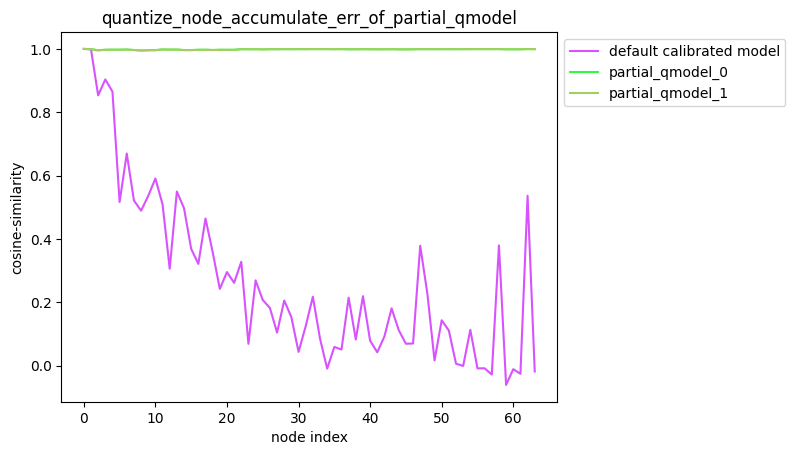

  • Multiple Nodes Quantization
Configuration method: quantize_node=[['Conv_2'], ['Conv_2', 'Conv_90']], where quantize_node is a nested list.
API usage:
dbg.plot_acc_error(
        save_dir='./',
        average_mode=False)
Command-line usage:
  hmct-debugger plot-acc-error calibrated_model.onnx calibration_data -q [['Conv_2'],['Conv_2','Conv_90']]
Description: When quantize_node is a nested list, for each sublist in quantize_node, the nodes specified in that sublist are quantized while keeping all other nodes unquantized. After generating the corresponding models, the output of each node is compared with the corresponding node output in the floating-point model to compute the error, and the corresponding cumulative error curves are obtained.
  • partial_qmodel_0: Only quantize the Conv_2 node, leave others unquantized;
  • partial_qmodel_1: Only quantize the Conv_2 and Conv_90 nodes, leave others unquantized.
When average_mode=False:
new_average_mode_false_1
When average_mode=True:
new_average_mode_true_1

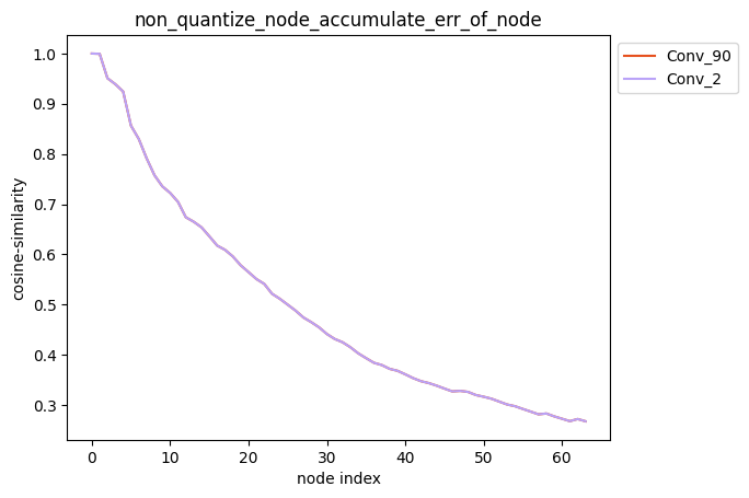

  • Single Node Dequantization
Configuration method: non_quantize_node=['Conv_2', 'Conv_90'], where non_quantize_node is a flat list.
API usage:
dbg.plot_acc_error(
        save_dir='./',
        average_mode=True)
Command-line usage:
  hmct-debugger plot-acc-error calibrated_model.onnx calibration_data -nq ['Conv_2','Conv_90'] -a True
Description: When non_quantize_node is a flat list, for each node in non_quantize_node, that node is dequantized (kept in float) while all other nodes remain quantized. After generating the corresponding models, the output of each node is compared with the corresponding node output in the floating-point model to compute the error, and the corresponding cumulative error curve is generated.
average_mode_false_2
average_mode_true_2

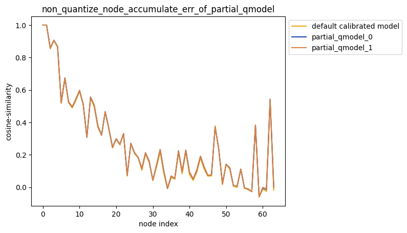

  • Multiple Nodes Dequantization
Configuration method: non_quantize_node=[['Conv_2'], ['Conv_2', 'Conv_90']], where non_quantize_node is a nested list.
API usage:
dbg.plot_acc_error(
        save_dir='./',
        average_mode=False)
Command-line usage:
  hmct-debugger plot-acc-error calibrated_model.onnx calibration_data -nq [['Conv_2'],['Conv_2','Conv_90']]

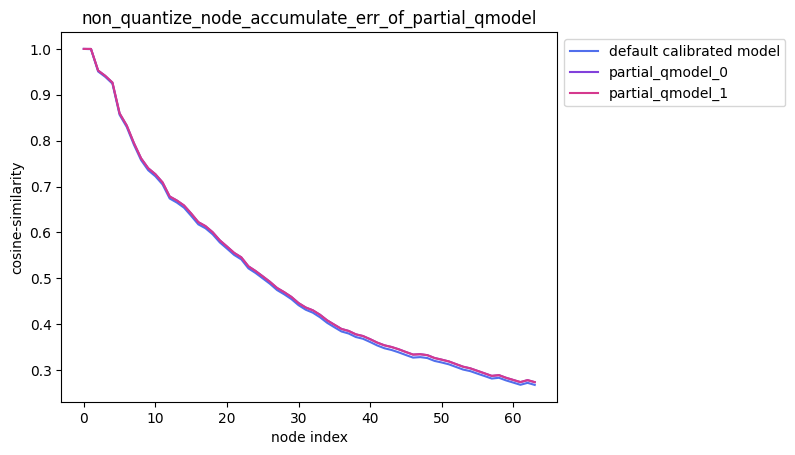

Description: When non_quantize_node is a nested list, for each sublist in non_quantize_node, the nodes in that sublist are kept unquantized while all other nodes are quantized. After generating the corresponding models, the output of each node is compared with the corresponding node output in the floating-point model to compute the error, and the corresponding cumulative error curves are obtained.
  • partial_qmodel_0: Do not quantize Conv_2, quantize all others;
  • partial_qmodel_1: Do not quantize Conv_2 and Conv_90, quantize all others.
new_average_mode_false_2
new_average_mode_true_2

3. Separate Weight and Activation Quantization
Configuration method: quantize_node=['weight','activation'].
API usage:
dbg.plot_acc_error(
        save_dir='./',
        quantize_node=['weight','activation'],
        average_mode=False)
Command-line usage:
  hmct-debugger plot_acc_error calibrated_model.onnx calibration_data -q ['weight','activation']
Description: quantize_node can directly specify 'weight' or 'activation'. Specifically:
  • quantize_node = ['weight']: Quantize only weights, not activations.
  • quantize_node = ['activation']: Quantize only activations, not weights.
  • quantize_node = ['weight', 'activation']: Quantize weights and activations separately.
weight_activation_quantized

nodes_list or -n Function: Specify nodes to analyze.
Description: Required, specifies the nodes for analysis.
For nodes in nodes_list:
- Weight calibration nodes: Plot original and calibrated weight distributions.
- Activation calibration nodes: Plot input data distribution of activation calibration nodes.
- Ordinary nodes: Plot output distributions before and after quantization, and their error distribution.
Note: nodes_list is of type List, allowing multiple nodes, and all three types can be specified simultaneously.
Range: All nodes in the calibrated model.
Default: None.

Analysis Results Presentation:
API usage:
  dbg.plot_distribution(
          save_dir='./',
          calibrated_data='./calibration_data',
          nodes_list=['317_HzCalibration', # Activation node
                      '471_HzCalibration', # Weight node
                      'Conv_2']) # Ordinary node
Command-line usage:
hmct-debugger plot-distribution calibrated_model.onnx calibration_data -n ['317_HzCalibration','471_HzCalibration','Conv_2']

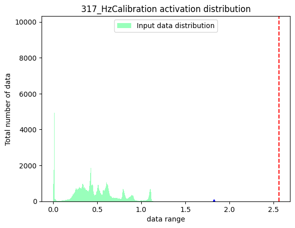

node_output:
node_output
weight:
weight
activation:
activation
Note:
In the three figures above, the blue triangle represents the maximum absolute value of the data. The red dashed line represents the smallest calibration threshold.

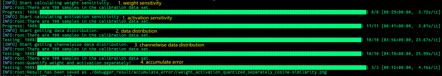

runall
Note:
The runall feature in the current version is only applicable to X5 products.
Function: Run all functionalities of the debug tool in one command.
Command-line format:
hmct-debugger runall MODEL_OR_FILE CALIBRATION_DATA --other options
Use hmct-debugger runall -h/--help to view parameters.

dis_nodes_list or -dnl Function: Specify nodes to analyze.
Description: Nodes for which to plot data distributions:
- Weight calibration nodes: Plot original vs. calibrated weights.
- Activation calibration nodes: Plot input data distribution.
- Ordinary nodes: Plot output distribution before/after quantization and error.
Note: dis_nodes_list is a list and can include multiple node types.

quantize_node or -qn Function: Quantize only specified nodes and observe cumulative error.
Description: Optional. Specifies nodes to quantize, others remain unquantized.
Whether single or partial quantization depends on whether the input is a nested list.
Examples:
- quantize_node=['Conv_2','Conv_9']: Quantize Conv_2 and Conv_9 individually.
- quantize_node=[['Conv_2'],['Conv_9','Conv_2']]: Test quantizing Conv_2 alone and both Conv_2 & Conv_9.
Special values: 'weight', 'activation':
- ['weight','activation']: Quantize both separately.
Note: quantize_node and non_quantize_node cannot both be None; at least one must be specified.
Range: All nodes in the model.
Default: None.
Optional
non_quantize_node or -nqn Function: Specify nodes to keep unquantized for cumulative error test.
Description: Optional. Nodes to keep in float, others fully quantized.
Determines single or multiple dequantization based on whether input is nested.
Examples:
- non_quantize_node=['Conv_2','Conv_9']: Dequantize Conv_2 and Conv_9 individually.
- non_quantize_node=[['Conv_2'],['Conv_9','Conv_2']]: Dequantize Conv_2 alone and both Conv_2 & Conv_9.
Default: None.
Optional

runall Workflow:
runall
When all parameters remain at their defaults, the tool performs the following steps sequentially:
  • Step 1 and Step 2: Obtain quantization sensitivity for weight calibration nodes and activation calibration nodes, respectively.
  • Step 3: Based on results from Step 1 and Step 2, plot data distributions for the top 5 weight calibration nodes and top 5 activation calibration nodes.
  • Step 4: For the nodes obtained in Step 3, plot box plots showing inter-channel data distributions.
  • Step 5: Plot cumulative error curves for quantizing weights only and activations only.
  • Step 6: Perform partial quantization and per-node accuracy analysis on sensitive nodes. Since the example in the figure does not specify sensitive_nodes, the debug tool must compute quantization sensitivity of regular nodes and select nodes with sensitivity below the specified pick_threshold for testing and analysis.
When node_type='node' is specified, the tool retrieves the top 5 nodes, finds the corresponding calibration nodes for each, and obtains their data distribution and box plots.

hb_perf Tool
hb_perf is a tool for analyzing the performance of X5 algorithm chain quantized hybrid models.
  • Usage
hb_perf [OPTIONS] BIN_FILE
  • Command-line Arguments
hb_perf command-line arguments:
–version
Show version and exit.
-m
Followed by model name. When BIN_FILE is a packed model, only outputs compilation information for the specified model.
–help
Show help information.
  • Output Description
Model information is output to the hb_perf_result folder in the current directory. A folder named after the model will be created, and model information will be displayed in an HTML file named after the model. The directory structure is shown in the example below:
  hb_perf_result/
  └── mobilenetv1
      ├── mobilenetv1
      ├── mobilenetv1.html
      ├── MOBILENET_subgraph_0.html
      ├── MOBILENET_subgraph_0.json
      └── temp.hbm
If the model was not compiled in debug mode (compiler_parameters.debug:True), hb_perf will display the following warning. This warning only indicates that subgraph information does not include per-layer details and does not affect the generation of overall model information.
2021-01-12 10:41:40,000 WARNING bpu model don't have per-layer perf info.
2021-01-12 10:41:40,000 WARNING if you need per-layer perf info please enable[compiler_parameters.debug:True] when use makertbin.

Tool output example:
hb_model_modifier resnet50_64x56x56_featuremap.bin
2022-04-21 18:22:30,207 INFO Nodes that can be deleted: ['data_res2a_branch1_HzQuantize_TransposeInput0', 'fc1000_reshape_0']
After specifying the -r option, the tool prints the node type, information stored in the bin file, and confirms the node has been removed:
hb_model_modifier resnet50_64x56x56_featuremap.bin -r data_res2a_branch1_HzQuantize_TransposeInput0
Node 'data_res2a_branch1_HzQuantize_TransposeInput0' found, its OP type is 'Transpose'
Node 'data_res2a_branch1_HzQuantize_TransposeInput0' is removed
modified model saved as resnet50_64x56x56_featuremap_modified.bin
Then, use hb_model_info to view deleted node information. The end of the output will list the names of deleted nodes, and a deleted_nodes_info.txt file will be generated, with each line recording initial information of the corresponding deleted node. Example:
hb_model_info resnet50_64x56x56_featuremap_modified.bin
Start hb_model_info....
hb_model_info version 1.7.0
********* resnet50_64x56x56_featuremap info *********
--------- deleted nodes -
deleted nodes: data_res2a_branch1_HzQuantize_TransposeInput0

  • Usage
    The basic workflow for loading and running ONNX models using HB_ONNXRuntime is shown below. This example code applies to inference for all ONNX models; simply prepare data according to the model’s input type and layout requirements:
import numpy as np
# Load Horizon Robotics dependency
# Prepare input for model execution
# Load the model file
sess = HB_ONNXRuntime(model_file = "model.onnx")
# Retrieve input and output node information
# Prepare input data; assuming this model has only one input
# Perform inference; the return value is a list corresponding to output_names in order
