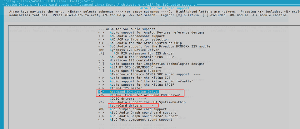

Enable Corresponding Config Options
audio_pdm_deconfig_setting
The above image shows GUI selection. The following platform config options must be confirmed:
CONFIG_SND_ARCHBAND_PDM
CONFIG_SND_VIRT_CODEC
CONFIG_SND_SOC_HOBOT_SIMPLE_CARD
CONFIG_SND_DUPLEX_CARD
CONFIG_SND_HOBOT_SOUND_MACHINE
CONFIG_SND_HOBOT_SOUND_DUPLEX_HOST
CONFIG_SND_SIMPLE_CARD_UTILS

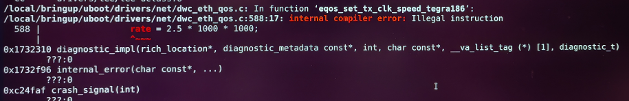

7.2.17. Internal Compiler Error: Illegal Instruction During SDK Compilation
Error Log:
image-20240319224834955
Cause: The arm-gnu-toolchain-11.3.rel1 GCC version has compatibility issues on older CPU models and cannot handle floating-point data. See details: Bug 5825 - Illegal instruction: 4 on questionable float conversion.
Solution: Upgrade the development host to use a newer CPU model.

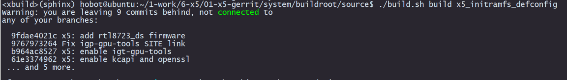

7.2.19. Warning: “You Are Leaving 9 Commits Behind” When Building Root Filesystem with Buildroot
Symptom: Warning: you are leaving 9 commits behind, not connected to
image-20240319224825834
Cause: This warning appears when recompiling buildroot. During the first build, patches from hb_patch_buildroot are applied to the buildroot source. On subsequent builds, this warning is shown.
Solution: This has no impact on compilation. The build script will restore the source to its initial state and reapply the patches.

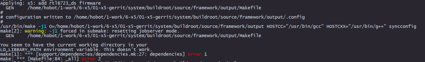

7.2.20. LD_LIBRARY_PATH Error When Building Root Filesystem with Buildroot
Symptom: When compiling buildroot to generate the root filesystem, the following error appears:
You seem to have the current working directory in your LD_LIBRARY_PATH environment variable. This doesn’t work.
image-20240319224814069
Cause: This indicates that LD_LIBRARY_PATH is already set in your environment variables, which is not allowed during buildroot compilation.
Solution: Check the contents of ~/.profile and ~/.bashrc, locate the LD_LIBRARY_PATH setting, comment it out, and log in to the terminal again. Run echo ${LD_LIBRARY_PATH} to verify it’s empty. Once cleared, compilation should proceed normally.

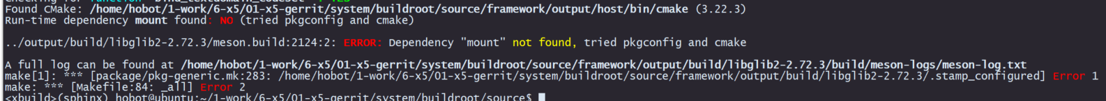

Symptom: ../output/build/libglib2-2.72.3/meson.build:2124:2: ERROR: Dependency “mount” not found, tried pkgconfig and cmake
image-20240319224801158
Cause: This error occurs when attempting to build the system filesystem immediately after building initramfs without cleaning.
Solution: After building initramfs, delete the framework/output directory and recompile the system.

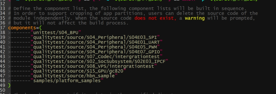

7.2.25. How to Include a New Code Directory in App Compilation
Solution: Code under the app directory is compiled by the build/mk_app.sh script. To add a new directory and include it in the build, add the directory name to the components list in build/mk_app.sh.
image-20240319225201040
build/mk_app.sh iterates over components, searching for build.sh (preferred) and Makefile in each directory. If found, it compiles them.
Note: Code in the app directory consists of independent test programs that may be added or removed as needed. Missing directories or absence of build.sh/Makefile will not cause overall build failure—only a warning about missing modules.

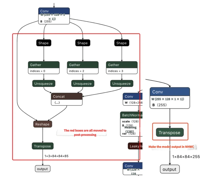

  • To better adapt to the post-processing code, we made the following modifications to the GitHub code before exporting the ONNX model (code reference: https://github.com/ultralytics/yolov5/blob/v2.0/models/yolo.py):
    def forward(self, x):
        # x = x.copy()  # for profiling
        z = []  # inference output
        self.training |= self.export
        for i in range(self.nl):
            x[i] = self.m[i](x[i])  # conv
            bs, _, ny, nx = x[i].shape  # x(bs,255,20,20) to x(bs,3,20,20,85)
            #  x[i] = x[i].view(bs, self.na, self.no, ny, nx).permute(0, 1, 3, 4, 2).contiguous()
            x[i] = x[i].permute(0, 2, 3, 1).contiguous()
  • Description: Removed the reshape operation from 4D to 5D at the end of each output branch (i.e., do not split channel from 255 into 3x85), then convert the layout from NHWC to NCHW before output.
    The left image below shows the visualization of one output node of the model before modification, and the right image shows the corresponding output node after modification.

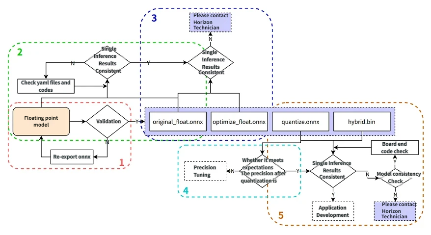

7.6.2.3. Model Accuracy Tuning Checklist
Please strictly follow steps 1–5 in the figure below to validate model accuracy and retain the code and results for each step:
model_accuracy_check
Before troubleshooting, confirm the Docker image or conversion environment version used for the current model conversion, and retain the version information.
1. Verify Inference Results of the Floating-Point ONNX Model
Enter the model conversion environment to test the single-image result of the floating-point ONNX model (specifically the ONNX model exported from the DL framework). The result of this step should be completely consistent with the inference result of the trained model (except for nv12 format, which may introduce slight differences).
Refer to the following example code steps to verify the correctness of the inference process, data preprocessing, and post-processing code for the floating-point ONNX model:
  import numpy as np
  import cv2
  def preprocess(input_name):
      # BGR->RGB, Resize, CenterCrop...
      # HWC->CHW
      # normalization
      return data
  def main():
      # Load model file
      sess = HB_ONNXRuntime(model_file=MODEL_PATH)
      # Get input & output node names
      input_names = [input.name for input in sess.get_inputs()]
      output_names = [output.name for output in sess.get_outputs()]
      # Prepare model input data
      feed_dict = dict()
      for input_name in input_names:
          feed_dict[input_name] = preprocess(input_name)
      # Original floating-point ONNX, data dtype=float32, start inference. The return value is a list, corresponding one-to-one with output_names.
      outputs = sess.run(output_names, feed_dict)
      # Post-processing
      postprocess(outputs)
  if __name__ == '__main__':
      main()
