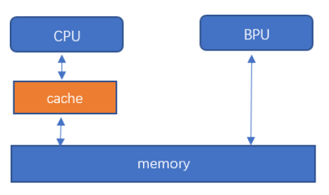

hbSysAllocCachedMem()
【Function Prototype】
int32_t hbSysAllocCachedMem(hbSysMem *mem, uint32_t size)
【Function Description】
Allocate cached BPU memory.
【Parameters】
  • [in] size Size of memory to allocate.
  • [out] mem Memory pointer.
【Return Type】
  • Returns 0 if the API executed successfully, otherwise execution failed.
hbSysFlushMem()
int32_t hbSysFlushMem(hbSysMem *mem, int32_t flag)
Flush cached BPU memory.
【Parameters】
  • [in] mem Memory pointer.
  • [in] flag Flush flag.
【Return Type】

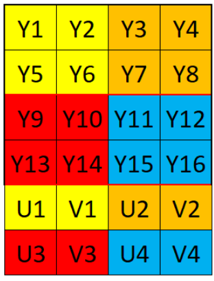

Introduction to NV12
YUV Format
YUV format is primarily used to optimize the transmission of color video signals. YUV consists of three components: Y represents luminance (i.e., grayscale), while U and V represent chrominance, describing color and saturation, and are used to specify pixel colors.
NV12 Layout
NV12 image format belongs to the YUV420SP format in the YUV color space. Every four Y components share one set of U and V components. Y components are stored sequentially, while U and V are interleaved.
The layout is as follows:
nv12_layout
