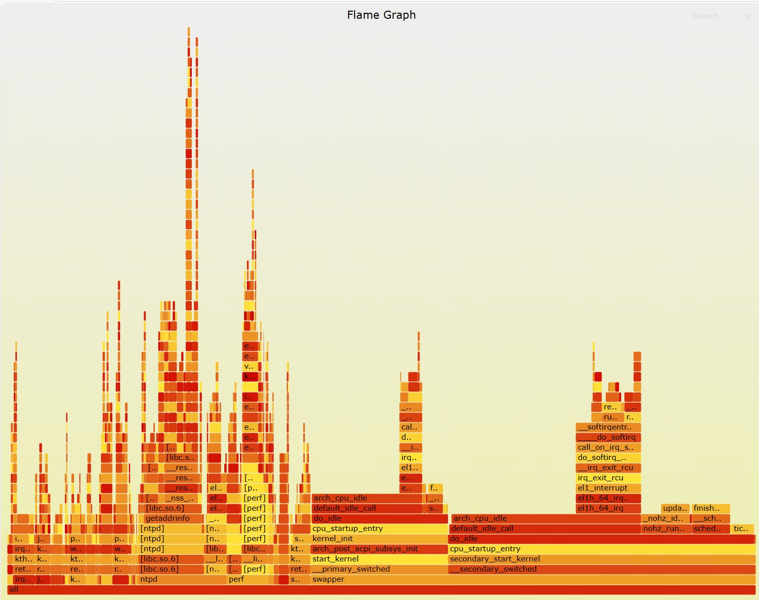

Generate Flame Graph with perf
Step 1

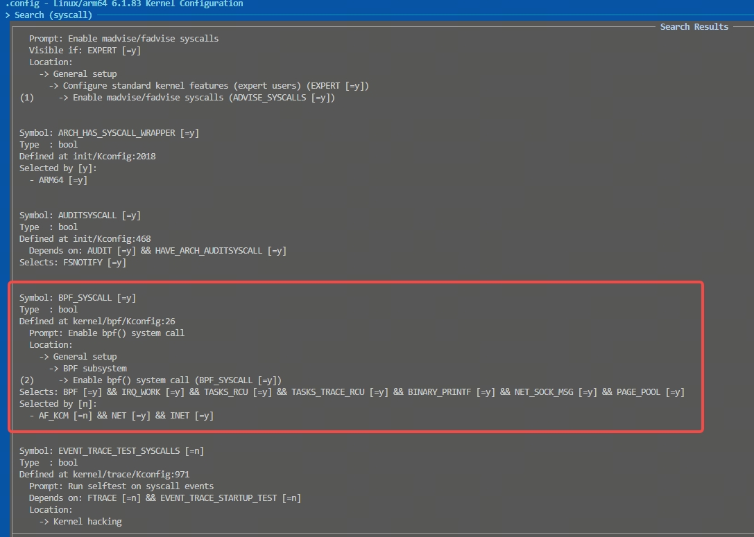

In the xbuild compilation system, use the following command to help users configure kernel options. This command automatically uses the kernel configuration file set in the board configuration file. After configuration, it automatically runs savedefconfig and saves the configuration. Enter the command as follows:
./bd.sh boot menuconfig
Enable BPF_SYSCALL, save the configuration, and recompile and flash the kernel.

Step 4
Use the flamegraph.pl script to generate an SVG image.
./flamegraph.pl perf.folded > perf.svg
Open the resulting SVG file in Chrome or an image viewer. The generated flame graph looks like this:
iperf
Flame Graph Interpretation
Core Structure of Flame Graph
  X-axis (horizontal)
    - Represents CPU time distribution. Wider blocks indicate functions or code paths that consume a higher proportion of CPU time, potentially indicating performance bottlenecks.
    - All call stacks at the same level are displayed side by side; they do not represent chronological order.
  Y-axis (vertical)
    - Represents call stack depth. Functions are shown from bottom to top, illustrating the call hierarchy.
    - The bottom layer is the program entry point (e.g., main function), and upper layers represent currently executing functions.
  Colors and Blocks
    - Colors are typically used only to differentiate functions and have no fixed meaning.
    - Tall and wide "flat-topped" flames (where the same function appears multiple times at the top of the stack) are key targets for performance optimization.
Steps for Flame Graph Analysis
  Identify CPU Hotspots
    - Open the SVG flame graph and horizontally scan for the widest blocks to quickly identify functions consuming the most CPU time.
  Analyze Call Chains
    - Trace the call path from bottom to top through each layer to understand how hot functions are invoked.
  Correlate with iperf Operation Mode
    - Server-side flame graph: Focus on CPU overhead in receiving logic such as accept, recv.
    - Client-side flame graph: Focus on performance cost in sending logic such as connect, send.
