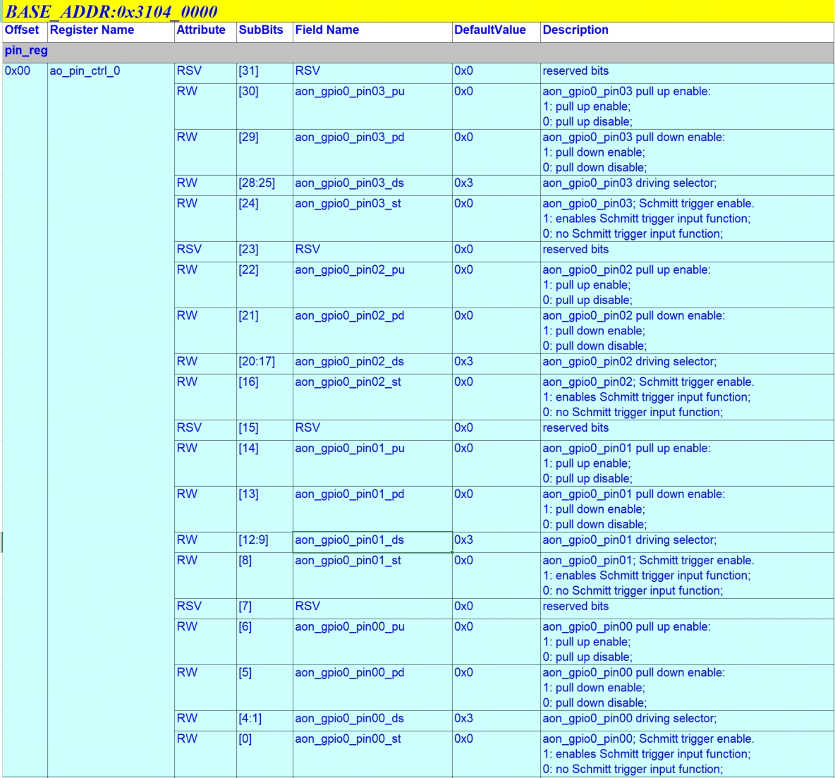

Take the aon_gpio_0 pin as an example, its base address and drive strength corresponding address are shown in the figure:

Field Interpretation:
Bits [12:9] of the read data match the default drive strength value of 3 as specified in the documentation.
