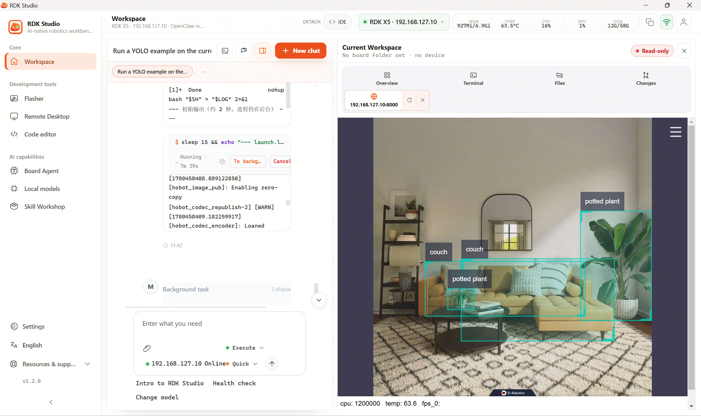

2.2 Restart and Web Verification
User Input
Stop the previous YOLO instance, relaunch YOLOv8n, and open the web page for me to view.
Full Conversation
AI Dock restarting YOLO and displaying the web view: The agent first uses device_exec to kill the old process (kill -9 67335 2>/dev/null || true), then relaunches YOLOv8n. The panel shows: "YOLOv8n object detection example restarted / New PID: 83250 / Log path: /tmp/rdkstudio-bg-82831.log / Status: USB camera, encoding, DNN inference, and web service all started successfully / Preview page opened: http://192.168.127.10:8000." A floating TogetheROS Web Display window on the right shows real-time camera feed with detected objects labeled as "keyboard" and "bed" in blue bounding boxes. Bottom metrics display cpu 1500000, temp 84.4, fps 0. Total time: 57 seconds.
Key observations:
  • Within a single conversation, the agent completes: process termination, restart, web page opening, and result validation.
  • The floating TogetheROS Web Display window is a browser preview automatically opened by Studio, showing real detection results.
  • Labels like keyboard / bed are actual objects detected by YOLOv8n; CPU usage, temperature, and FPS metrics are displayed at the bottom.

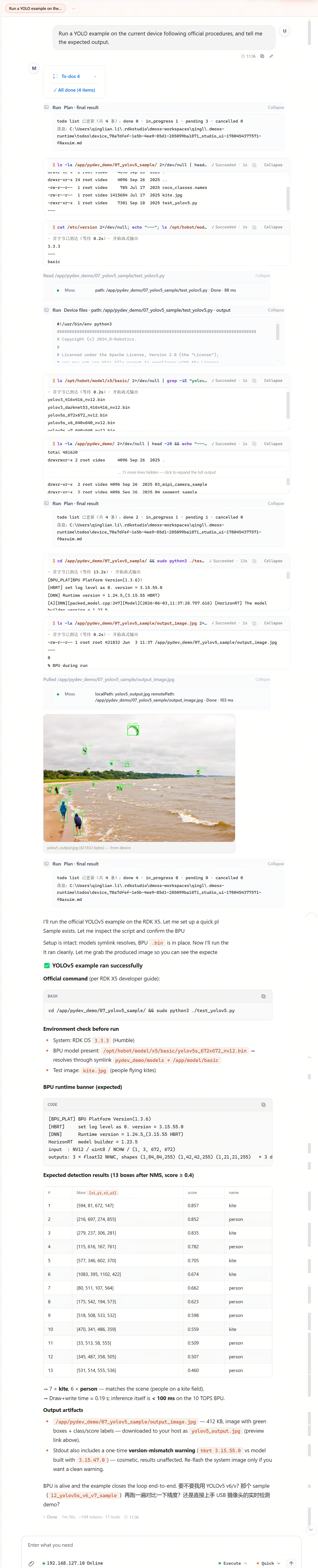

Case 3: Generating a Community Forum Draft from Hands-On Experience
User Input
Summarize the process of successfully running YOLO-World into a community forum draft, including environment setup, steps, real-world performance, common issues, and advanced tips.
Conversation Output
AI Dock generating a community forum draft: Title reads "[Copy-Paste Ready Draft]," body titled "Running YOLO-World Open-Vocabulary Object Detection on RDK X5 in 5 Minutes." Sections include—Environment & Preparation (Device: RDK X5 8GB; OS: Official RDK Ubuntu 22.04 + TROS Humble; Camera: Standard USB plug-and-play 720P; Software: tros-humble-hobot-yolo-world v0.4.1); Complete Execution Steps (1. Install software / 2. Prepare config & environment / 3. Launch detection service—with separate bash commands for USB camera, MIPI camera, and local image test versions); Real-World Performance Table (Inference FPS ~6 / Per-frame latency ~150ms / BPU utilization ~60% / Full-partition resource usage 76bit); Viewing Results (via http://device-IP:8000 or studio_open_url for pop-up window); Common Issues & Fixes (5 scenarios: browser not opening, successful launch but blank page, camera not working, unstable bounding boxes, no detections—with root causes and troubleshooting commands); Advanced Tips (custom detection categories via yolo_world_texts, saving results, further development); Conclusion recommends directly copying these steps.
Key observations:
  • The draft follows a standard community post structure: environment, steps, real-world results, troubleshooting, and advanced usage.
  • Bash commands, paths, and package versions in the steps are directly sourced from the actual execution in Case 2.
  • Real-world performance metrics (FPS, latency, BPU usage) are extracted from logs by the agent.
  • "Common Issues & Fixes" are derived from the agent’s internalized experience and document retrieval—not hallucinated.
