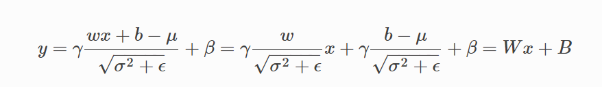

7.3.2.5. Purpose of BN (Batch Normalization) Absorption
BN absorption aims to reduce the computation of the deployed model. Since BN is a linear transformation process, the transformation parameters of BN can be absorbed into the Conv parameters when BN and Conv appear together, thereby eliminating the computation of BN in the deployed model.
Convert Conv2d + BN2d to Conv2d by absorbing BN .
../../../_images/absorb_bn.svg
7.3.2.6. BN Absorption Method
Currently the tool supports the Conv -> BN mode to absorb BN .
The absorption method is as follows:
