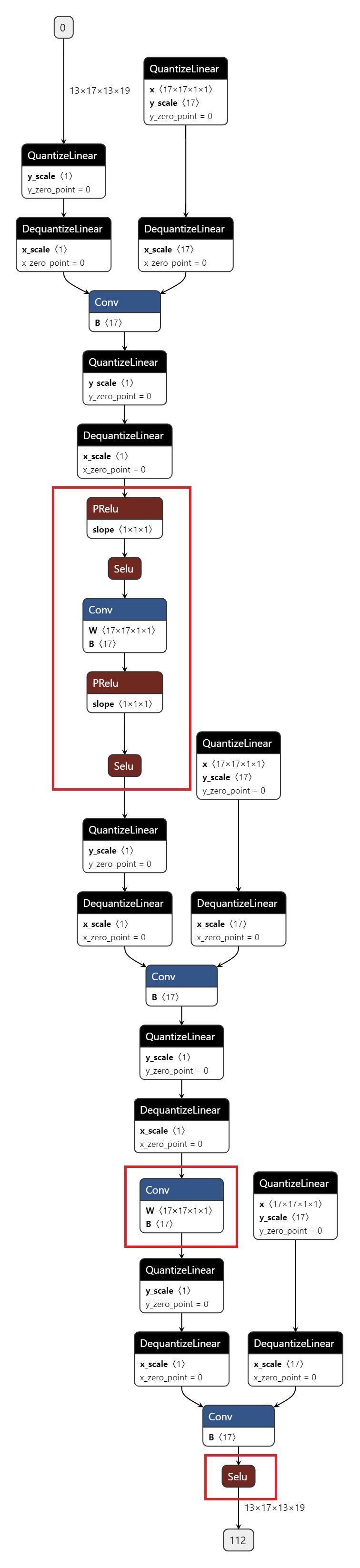

7.3.4. Heterogeneous Model QAT
7.3.4.1. Differences Between Heterogeneous Models and Non-heterogeneous Models
Heterogeneous models are those that run partly on the BPU and partly on the CPU during deployment, while non-heterogeneous models run completely on the BPU during deployment. Generally, the following two types of models will become heterogeneous when deployed:

prepare_qat_fx: Specify the hybrid mode and set dict as required.
convert_fx: Don’t need to specify the mode. The mode will be automatically selected based on the model generated by prepare_qat_fx.
convert_fx: Specify the hybrid mode
export_to_onnx: Non heterogeneous mode is only used for visualization. Heterogeneous mode is exported to onnx followed by hb mapper
compile/perf/check_model: None.

    To verify the correctness of the model, you can skip steps 8 and 9 after prepare_qat_fx. First export onnx to view the model structure according to step 10, and then execute step 8 after verifying that there is no problem.
  8. training .
  9. Call convert_fx . Optional. It can be skipped when there is no requirement to evaluate the precision of the fixed-point model.

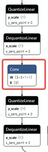

  10. Call export_ to_ onnx. You can also use torch.onnx.export , but you need to follow the precautions in the export_to_onnx interface description.
  11. Use hb_mapper to transform the onnx model. After conversion, it is necessary to check whether the operator is running on the expected device. In some cases, hb_mapper still needs to set the run_on_cpu parameter. For example: although conv is not quantized in the QAT stage, since its input (the output of the previous operator) has been fake quantized, hb_mapper will still quantize it by default.

The exported onnx is shown in the figure. The part circled in red is the CPU operator.
