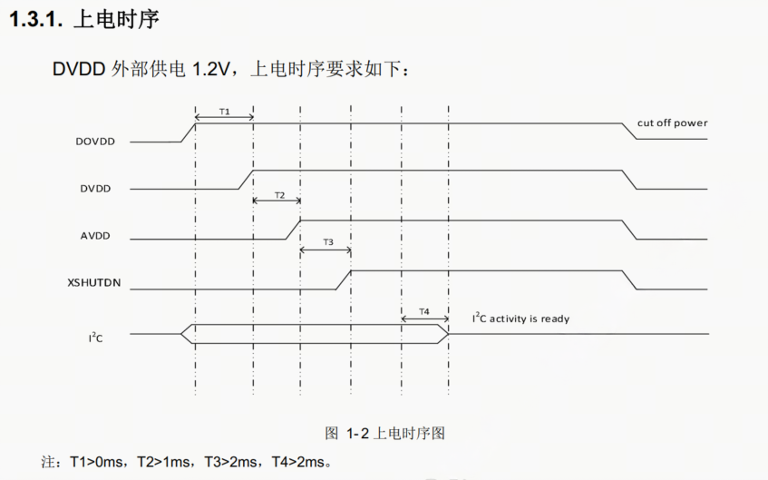

power_on
  2. sensor_poweron 一般在 sensor_init 中调用,只需要控制 XSHUTDN 即可,以下为 sc132gs power_on的代码实现:
../../_images/screenshot-20260210-145501.png
int sensor_poweron(sensor_info_t *sensor_info)
        int gpio, ret = RET_OK;
                                usleep(1 * 100 * 1000);  // 100ms
                                if(ret < 0) {
                                usleep(100 * 1000);  // 100ms
        return ret;

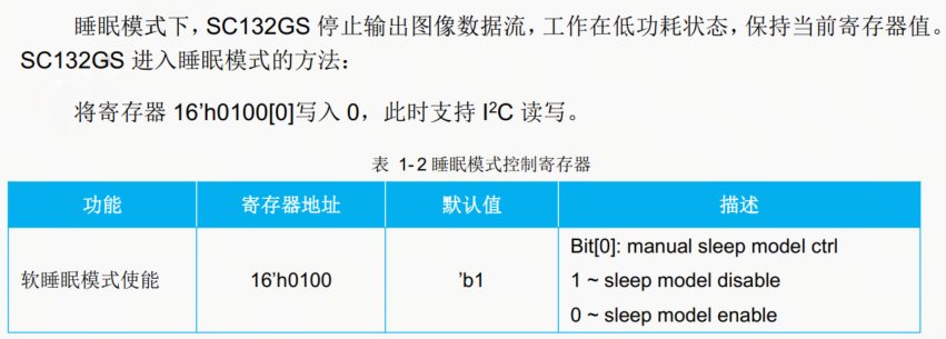

start
  1. start 实现下发开流寄存器0x0100 为0x01,使 sensor 出流。
  2. sensor_start 调用时机为 上层调用 hbn_vflow_start。
../../_images/screenshot-20260210-204357.png
int sensor_start(sensor_info_t *sensor_info)
        int ret = RET_OK;
        int setting_size = 0;
        switch(sensor_info->sensor_mode) {
        case NORMAL_M:
        case SLAVE_M:
                setting_size = sizeof(sc132gs_stream_on_setting)/sizeof(uint32_t)/2;
                vin_info(" start linear mode, sensor_name %s, setting_size = %d\n", sensor_info->sensor_name, setting_size);
                                setting_size, sc132gs_stream_on_setting);
                if(ret < 0) {
                        vin_err("start %s fail\n", sensor_info->sensor_name);
                        return ret;
                break;
        return ret;
stop
  1. stop 实现下发关流寄存器 0x0100 为0x00,使 sensor 关流。

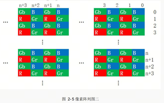

  • sensor_data_bayer_fill(..., 10, BAYER_START_B, BAYER_PATTERN_RGGB);sensor_data_bits_fill(..., 12),0,0位置BAYER_START是 BAYER_START_B,BAYER_PATTERN是RGGB,raw10格式,sensor_data_bits_fill pwl mode 才会用到,这里配置12即可

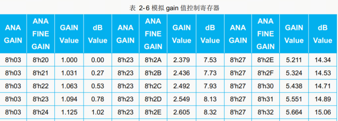

aexp_gain_control
  • 对于 SmartSens 的sensor gain控制,一般采用的是 离散档位 + 精细调节,通常查表是最快的,根据表生成直接填写 agin_lut 和 dgain_lut即可(不需要使用 gain_table.xlsx),比较方便快捷
  • SmartSens 使用 again + dgain 两路 LUT,寄存器为 AGAIN 0x3e08/0x3e09、DGAIN 0x3e06/0x3e07。根据 ISP 下发的 again[0]/dgain[0] 索引查表.

        const uint16_t AGAIN_LOW = 0x3e08;
        const uint16_t AGAIN_HIGH = 0x3e09;
        const uint16_t DGAIN_LOW = 0x3e06;
        const uint16_t DGAIN_HIGH = 0x3e07;
        char ana_gain = 0, ana_fine_gain = 0;
        char dig_gain = 0, dig_fine_gain = 0;
        int again_index = 0, dgain_index = 0;
        if (mode == NORMAL_M || mode == DOL2_M) {
                if (again[0] >= sizeof(sc132gs_gain_lut)/sizeof(uint32_t))
                        again_index = sizeof(sc132gs_gain_lut)/sizeof(uint32_t) - 1;
                else
                        again_index = again[0];
                if (dgain[0] >= sizeof(sc132gs_dgain_lut)/sizeof(uint32_t))
                        dgain_index = sizeof(sc132gs_dgain_lut)/sizeof(uint32_t) - 1;
                else
                        dgain_index = dgain[0];
                ana_gain = (sc132gs_gain_lut[again_index] >> 8) & 0xFF;
                ana_fine_gain = sc132gs_gain_lut[again_index] & 0xFF;
                dig_gain = (sc132gs_dgain_lut[dgain_index] >> 8) & 0xFF;
                dig_fine_gain = sc132gs_dgain_lut[dgain_index] & 0xFF;
                vin_i2c_write8(info->bus_num, 16, info->sensor_addr, AGAIN_LOW, ana_gain);
                vin_i2c_write8(info->bus_num, 16, info->sensor_addr, AGAIN_HIGH, ana_fine_gain);
                vin_i2c_write8(info->bus_num, 16, info->sensor_addr, DGAIN_LOW, dig_gain);
                vin_i2c_write8(info->bus_num, 16, info->sensor_addr, DGAIN_HIGH, dig_fine_gain);
                if (mode == DOL2_M) {
                        vin_i2c_write8(info->bus_num, 16, info->sensor_addr, 0x3e12, ana_gain);
                        vin_i2c_write8(info->bus_num, 16, info->sensor_addr, 0x3e13, ana_fine_gain);
                        vin_i2c_write8(info->bus_num, 16, info->sensor_addr, 0x3e10, dig_gain);
                        vin_i2c_write8(info->bus_num, 16, info->sensor_addr, 0x3e11, dig_fine_gain);
        } else {
        return 0;

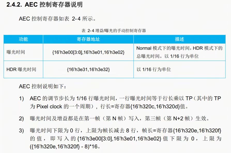

aexp_line_control
aexp_line_control这个函数是主要实现了曝光的控制,主要负责:
  1. 接收ISP 3A算法计算的下发的曝光的行数
  2. 将曝光的行数转换为sensor寄存器值
  3. 配置通过i2c下发给sensor 曝光寄存器
  4. 这里曝光寄存器为 0x3e00、0x3e01、0x3e02。
static int sc132gs_ae_set(uint32_t bus, uint32_t addr, uint32_t line)
        const uint16_t EXP_LINE0 = 0x3e00;
        const uint16_t EXP_LINE1 = 0x3e01;
        const uint16_t EXP_LINE2 = 0x3e02;
        uint32_t sline = line;
        if (sline >= 2560) sline = 2560;
        temp0 = (sline & 0xF000) >> 12;
        temp1 = (sline & 0x0FF0) >> 4;
        temp2 = (sline & 0x000F) << 4;
        vin_i2c_write8(bus, 16, addr, EXP_LINE0, temp0);
        vin_i2c_write8(bus, 16, addr, EXP_LINE1, temp1);
        vin_i2c_write8(bus, 16, addr, EXP_LINE2, temp2);
        return 0;
