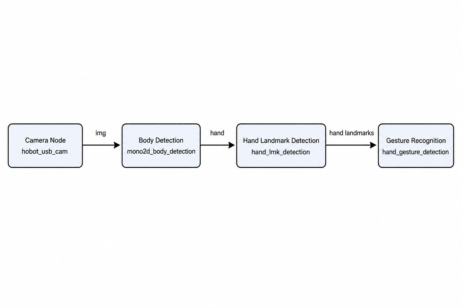

Recognition Pipeline
This feature includes body detection, hand landmark detection, and gesture recognition. It uses ROS, and recognition is split across multiple nodes. The feature is packaged in TROS. The pipeline is as follows:
The message type is PerceptionTargets. For gesture message handling, see the on_gesture_msg function in the sample code. Get the sample code in Environment Setup.
