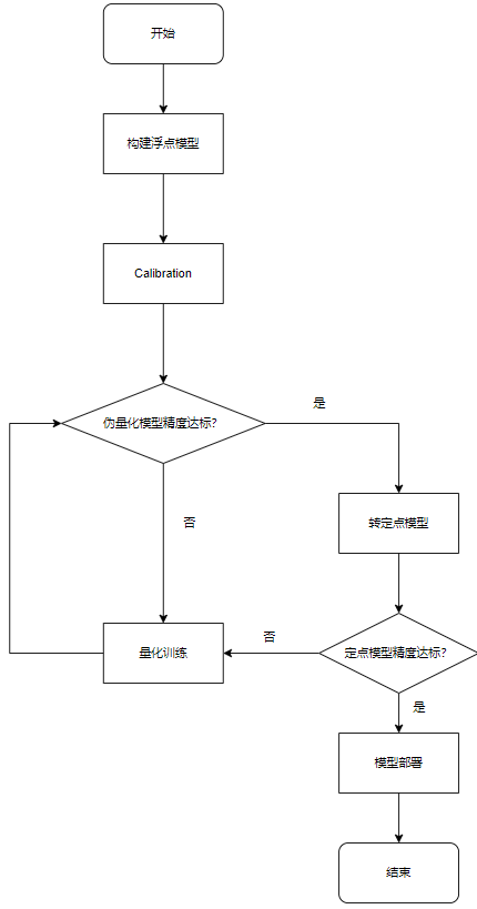

6.4.2.1. 基本流程
量化训练工具的基本使用流程如下:
quick_start

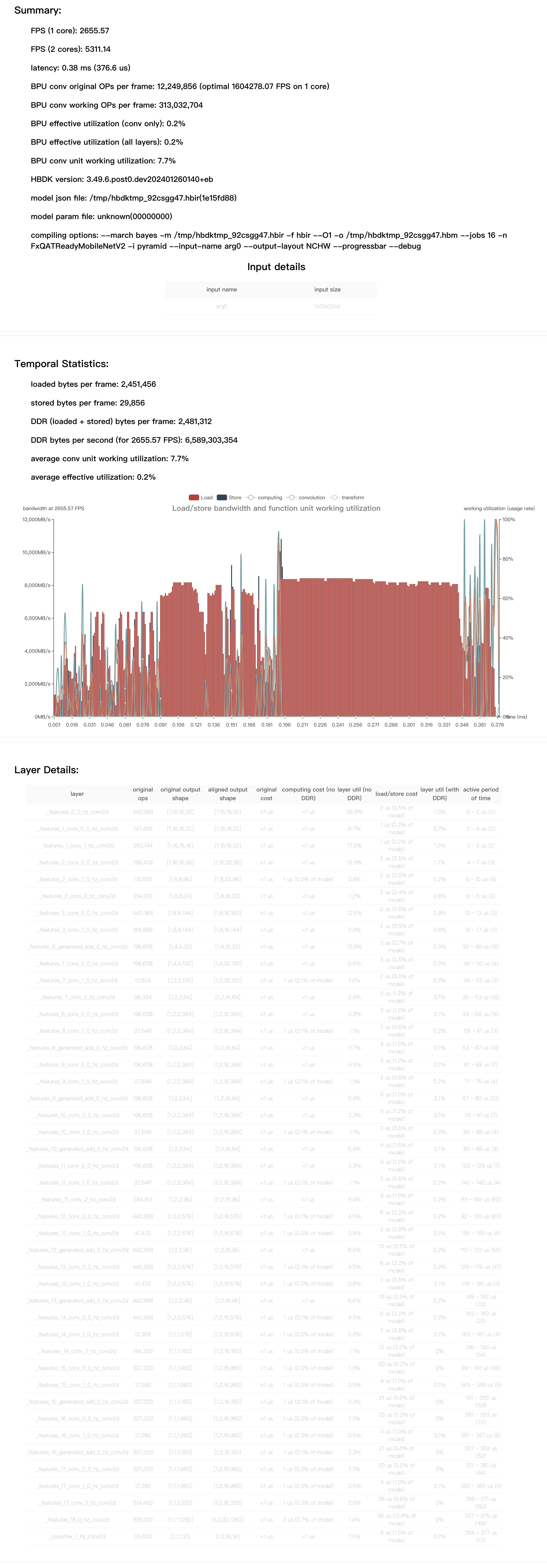

    FPS=2655.57, latency = 376.6 us, DDR = 2481312 bytes   (see model/mobilenetv2/perf_out/FxQATReadyMobileNetV2.html)
HBDK model compilation SUCCESS
HBDK performance estimation SUCCESS
根据提示,找到性能结果文件,内容如下:
perf_model
