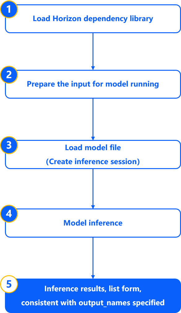

The HB_ONNXRuntime is an ONNX model inference library for the x86 side packaged by D-Robotics based on the public version of ONNXRuntime. In addition to supporting the original ONNX models directly exported by Pytorch, TensorFlow, PaddlePaddle, MXNet and other training frameworks, it also supports inferring the various stages of ONNX models generated during the PTQ conversion process of the D-Robotics toolchain. The usage flow is shown as follows:
../../../../_images/hb_onnxruntime.png

4.1.2.11.1. How to Use
The basic flow for loading ONNX model inference using HB_ONNXRuntime is shown below, and this sample code applies to inference for all ONNX models. Prepare the data according to the input type and layout requirements of different models:
