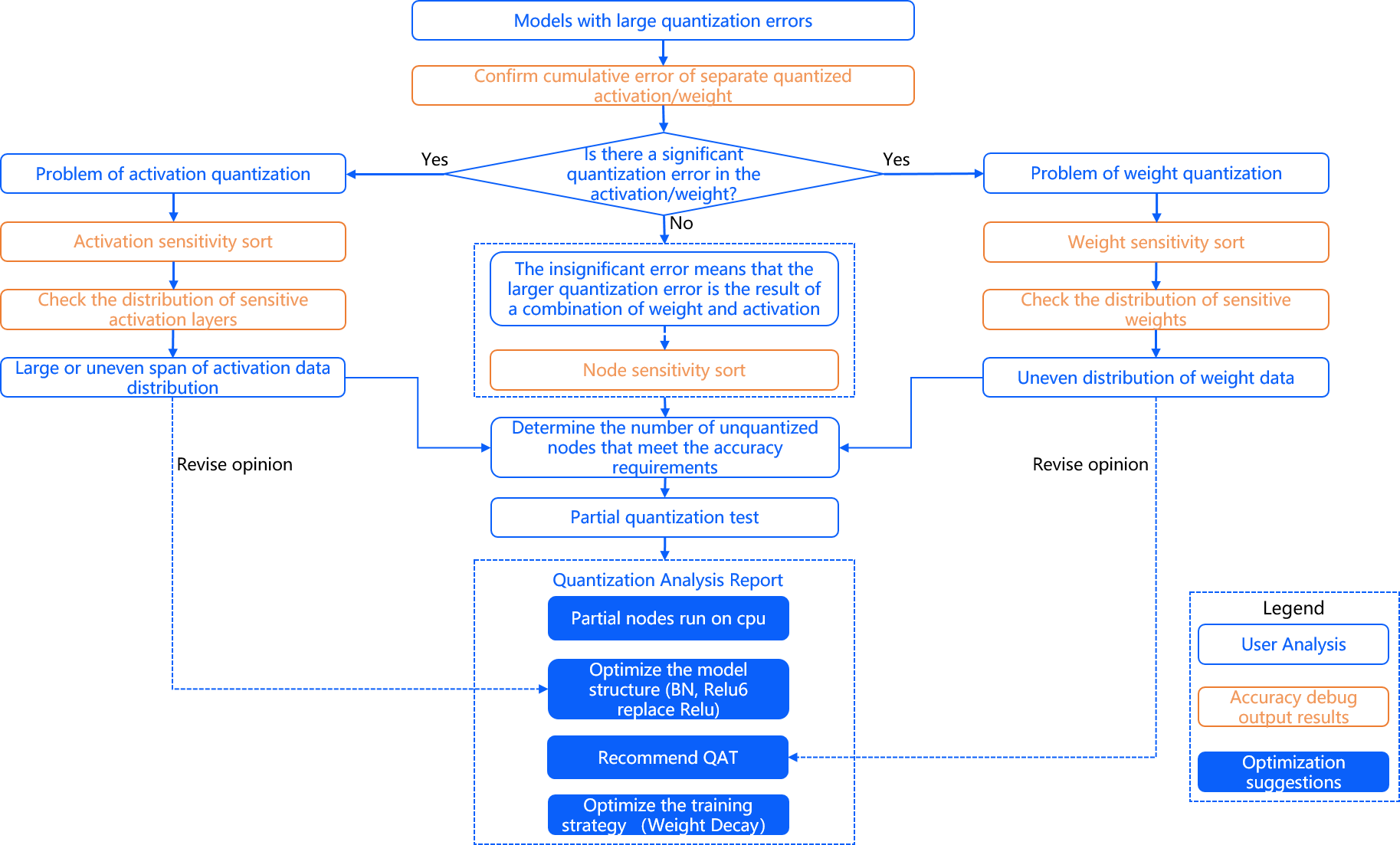

There are several steps to use the accuracy debug tool as follows:
1.Configure the parameter debug_mode: "dump_calibration_data" in the model_parameters group in yaml to save the calibration data.
2.Import the debug module and load the calibration model and data.
3.Analyze the models with significant accuracy loss through the API provided by the accuracy debug tool.
The overall process is shown as the follow:

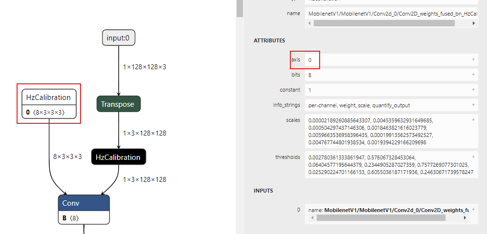

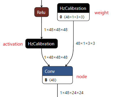

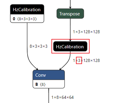

Calibration model (calibrated_model.onnx) interpretation
The calibration model is an intermediate product obtained by the model transformation tool chain by taking the floating point model after structural optimization, calculating the quantization parameters corresponding to each node from the calibration data and saving them in the calibration node. The main feature of the calibration model is that the model contains calibration nodes with the node type HzCalibration. These calibration nodes are divided into two main categories: activation calibration nodes and weight calibration nodes .
The input of activation calibration node is the output of the previous node of the current node, and the input data is quantized and inverse quantized based on the quantization parameters (scales and thresholds) saved in the current activation calibration node and then output.
The input of weight calibration node is the original floating point weights of the model, and the input original floating point weights are quantized and inverse quantized based on the quantization parameters (scales and thresholds) saved in the current weight calibration node and then output.
In addition to the above calibration nodes, other nodes in the calibration model are called general nodes by the accuracy debug tool. The types of general nodes are: Conv, Mul, Add, etc.
../../../../_images/debug_node.png

  • activation: The activation calibration node name.
  • node: The common node after the activation calibration node in the model structure, i.e., the output of the activation calibration node is its input.
  • threshold: The calibration threshold, and the maximum value is taken if there are multiple thresholds.
  • bit: The quantization bit.
  • cosine-similarity, mse: The quantization sensitivity values of each node.

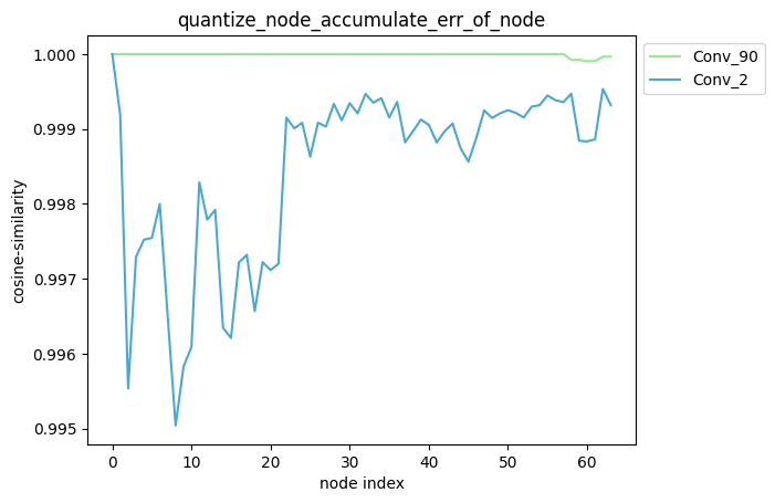

Analysis results presentation:
1.Specify the node to quantify the cumulative error test:
  • Specify single-node quantization
Configuration method: quantize_node=[‘Conv_2’, ‘Conv_90’], quantize_node is single list.
API Usage:
# Import the debug module
import horizon_nn.debug as dbg
dbg.plot_acc_error(
        save_dir='./',
        calibrated_data='./calibration_data/',
        model_or_file='./calibrated_model.onnx',
        quantize_node=['Conv_2', 'Conv_90'],
        metric='cosine-similarity',
        average_mode=False)
Command Line Usage:
hmct-debugger plot-acc-error calibrated_model.onnx calibrated_data -q ['Conv_2','Conv_90']

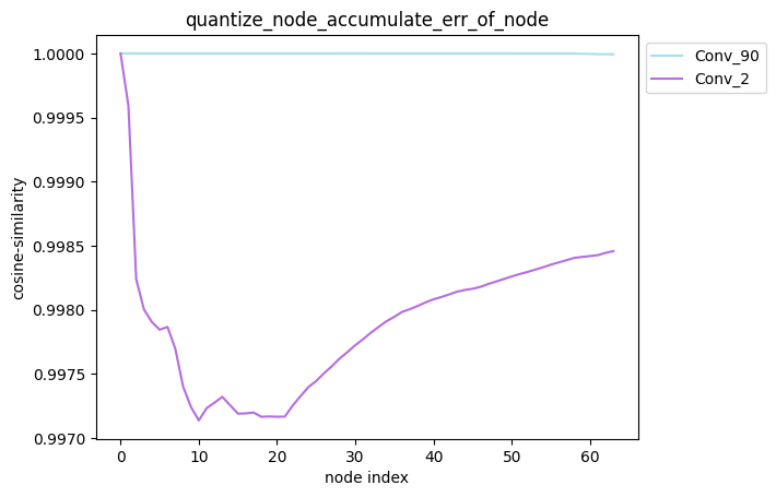

Description: When quantize_node is a single list, for the quantize_node you set, quantize the nodes in the quantize_node separately and keep the other nodes in the model unquantized to get the corresponding model, and then calculate the error between the output of each node in the model and the output of the corresponding node in the floating-point model, and get the corresponding cumulative error curve.
When average_mode = False:
../../../../_images/average_mode_false_1.png
When average_mode = True:
../../../../_images/average_mode_true_1.png

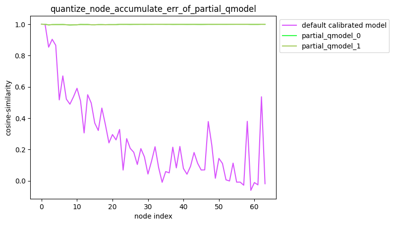

  • Specify multiple nodes for quantization
Configuration method: quantize_node=[[‘Conv_2’], [‘Conv_2’, ‘Conv_90’]],quantize_node is nested list.
API Usage:
dbg.plot_acc_error(
        save_dir='./',
        quantize_node=[['Conv_2'], ['Conv_2', 'Conv_90']],
        average_mode=False)
Command Line Usage:
hmct-debugger plot-acc-error calibrated_model.onnx calibration_data -q [['Conv_2'],['Conv_2','Conv_90']]
Description: When quantize_node is a nested list, for the quantize_node you set, quantize the nodes specified for each single list in the quantize_node separately and keep the other nodes in the model unquantized to get the corresponding model, then calculate the error between the output of each node in the model and the output of the corresponding node in the floating-point model, and get the corresponding cumulative error curve.
  • partial_qmodel_0: Only quantize the Conv_2 node, the rest of the nodes are not quantized;
  • partial_qmodel_1: Only the Conv_2 and Conv_90 nodes are quantified, and the rest of the nodes are not quantified.
../../../../_images/new_average_mode_false_1.png
../../../../_images/new_average_mode_true_1.png

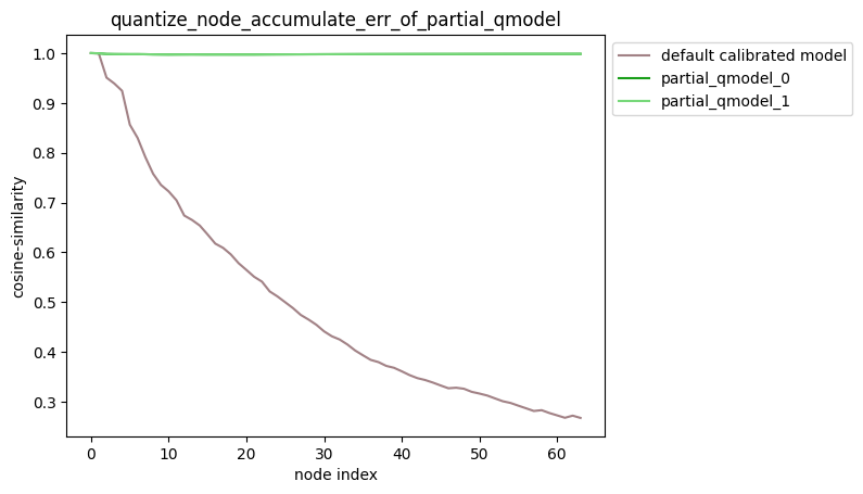

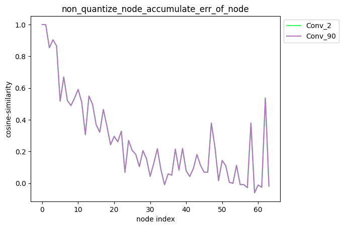

2.Cumulative error test after unquantizing some nodes of the model
  • Specify single node not quantified
Configuration method: non_quantize_node=[‘Conv_2’, ‘Conv_90’],non_quantize_node is single list.
API Usage:
dbg.plot_acc_error(
        save_dir='./',
        non_quantize_node=['Conv_2', 'Conv_90'],

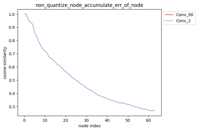

        average_mode=True)
Command Line Usage:
hmct-debugger plot-acc-error calibrated_model.onnx calibration_data -nq ['Conv_2','Conv_90'] -a True
Description: When the non_quantize_node is a single list, for the non_quantize_node you set, unquantize each node in the non_quantize_node separately while keeping all other nodes quantized, and then get the corresponding model, calculate the error between the output of each node in the model and the output of the corresponding node in the floating-point model, and get the corresponding cumulative error curve.
../../../../_images/average_mode_false_2.png
../../../../_images/average_mode_true_2.png
  • Specify multiple nodes not to quantize
Configuration method: non_quantize_node=[[‘Conv_2’], [‘Conv_2’, ‘Conv_90’]],non_quantize_node is nested list.
API Usage:
dbg.plot_acc_error(
        save_dir='./',
        non_quantize_node=[['Conv_2'], ['Conv_2', 'Conv_90']],
        average_mode=False)
Command Line Usage:
hmct-debugger plot-acc-error calibrated_model.onnx calibration_data -nq [['Conv_2'],['Conv_2','Conv_90']]

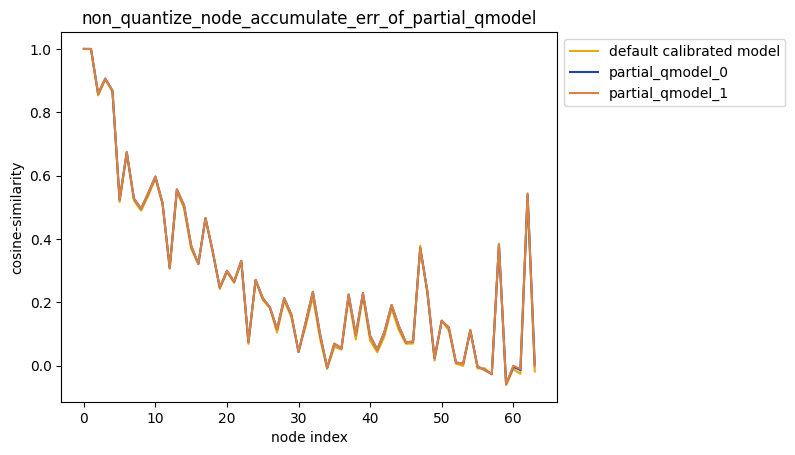

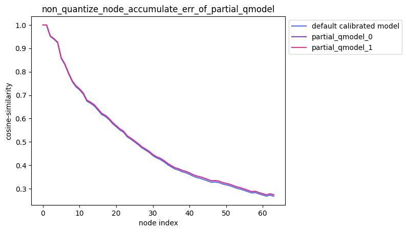

Description: When non_quantize_node is a nested list, for the non_quantize_node you set, do not quantize each node specified in the non_quantize_node and keep all the other nodes in the model quantized, and get the corresponding model, then calculate the error between the output of each node in the model and the output of the corresponding node in the floating-point model, and get the corresponding cumulative error curve.
  • partial_qmodel_0: No quantization of Conv_2 nodes and quantization of the remaining nodes;
  • partial_qmodel_1: No quantization of Conv_2 and Conv_90 nodes, and quantization of the rest of the nodes.
../../../../_images/new_average_mode_false_2.png
../../../../_images/new_average_mode_true_2.png

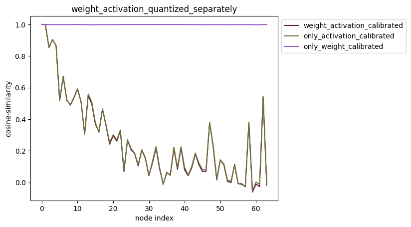

3.Activation weights are quantified separately
Configuration method: quantize_node=[‘weight’,’activation’].
API Usage:
dbg.plot_acc_error(
        save_dir='./',
        quantize_node=['weight', 'activation'],

hmct-debugger plot-acc-error calibrated_model.onnx calibration_data -q ['weight','activation']
Description: The quantize_node can also be specified directly as ‘weight’ or ‘activation’.
  • quantize_node = [‘weight’]: Quantify weights, not activation.
  • quantize_node = [‘activation’]: Quantify activation, not weights.
  • quantize_node = [‘weight’, ‘activation’]: Weights and activations are quantified separately.
../../../../_images/weight_activation_quantized.png
Note

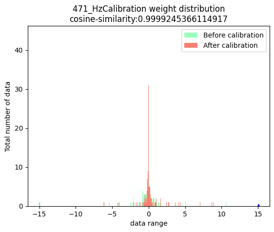

When node_type = ‘node_output’:
../../../../_images/node_output.png
When node_type = ‘weight’:
../../../../_images/weight.png
When node_type = ‘activation’:
../../../../_images/activation.png
Note
In the above three pictures, the blue triangle indicates that the maximum value of the absolute data. The red dashed line indicates that the maximum calibration threshold.
dbg.get_channelwise_data_distribution(
        save_dir: str,
        model_or_file: ModelProto or str,
        calibrated_data: str or CalibrationDataSet,
        nodes_list: List[str],
        axis: int = None)
Description: For your set calibration node list(node_list), get the dimension where the channel is located from the parameter axis, and get the data distribution among the node input data channels. Where axis is None by default, if the node is a weight calibration node, then the dimension where the channel is located is 0 by default; if the node is an activation calibration node, then the dimension where the channel is located is 1 by default.
Weight calibration node:
../../../../_images/weight_calibration_node.png
Activation calibration node:
../../../../_images/activate_calibration_node.png

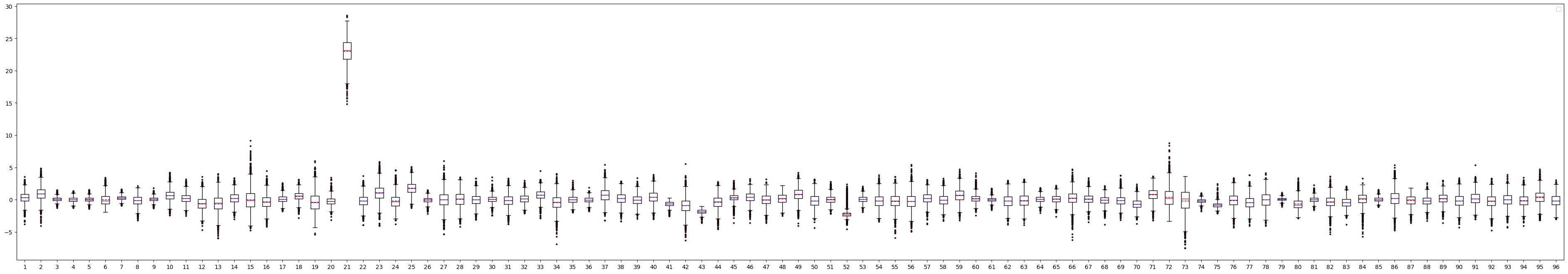

The output is shown as follows:
../../../../_images/box_plot.png
In the figure:
  • The horizontal coordinate indicates the number of channels of input data of the node, and there are 96 channels of input data in the figure example.
  • The vertical coordinate indicates the data distribution range of each channel, where the red solid line indicates the median of the data in that channel and the blue dashed line indicates the mean. The upper and lower limits of each box indicate the upper quartile and the lower quartile, respectively, and the discrete points outside the upper and lower limits indicate the outliers, and the maximum of the absolute value of these outliers is observed to determine whether the current node input data is experiencing large fluctuations.
