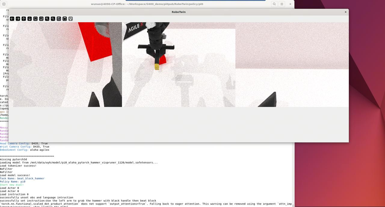

Render Well
============= Config =============
Messy Table: False
Random Background: False
Random Light: False
Random Table Height: 0
Random Head Camera Distance: 0
Head Camera Config: D435, True
Wrist Camera Config: D435, True
Embodiment Config: aloha-agilex
missing pytorch3d
No model loaded!
Load tokenizer success!
NoFilter
NoFilter
Load model success!
Task Name: beat_block_hammer
Policy Name: pi0
Start new eval!
服务器启动成功,等待客户端连接...(端口:30001)
客户端已连接:IP=221.226.80.67, 端口=58799
发送成功,长度:691484字节
接收成功,长度:5651字节
===== 解析 Header 信息 =====
序列号 : 1
时间戳: 1770106723.508825449
====== 解析 Body 信息 ======
接收到 0 个图像张量:
接收到 1 个嵌入张量:
语言0:类型=0,维度=1 50 14
接收到 0 个状态张量:
step: 1 / 400
VLA 运行效果
