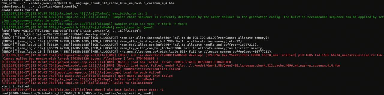

Q1:出现“Cannot malloc bpu memory with length xxxx bytes: AllocError { len: xxxx}”​
BPU 内存分配失败报错
A: 请确认内存模式是否切换成功
# 使用 balanced 模式
/usr/hobot/bin/hb_switch_ion.sh balanced
# 重启生效
reboot

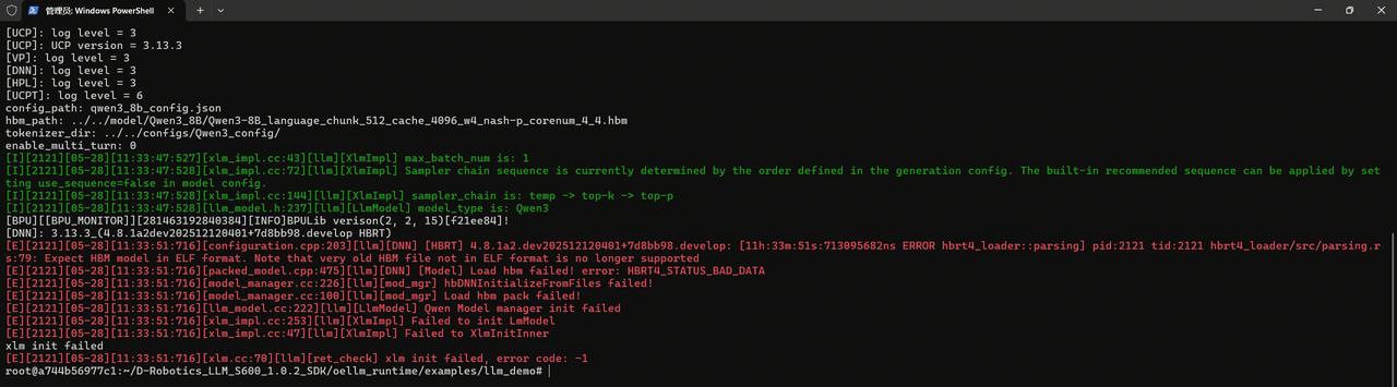

Q2: 出现“ Expect HBM model in ELF format. Note that veryold HBM file not in ELF format is no longer support”​
HBM 模型格式错误报错
A: 请检查模型下载是否完整,可查看 md5
md5sum xxxxxx
#模型 md5 值表
wget https://d-robotics-aitoolchain.oss-cn-beijing.aliyuncs.com/llm_s600/1.0.0/models/md5sum.txt
