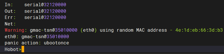

After configuration, upon fault-induced reboot, the system will enter the uboot command line. uboot-ubootonce
Perform mem-dump to emmc
Execute the following command in uboot to dump memory to the userdata partition of emmc:
memdump userdata
