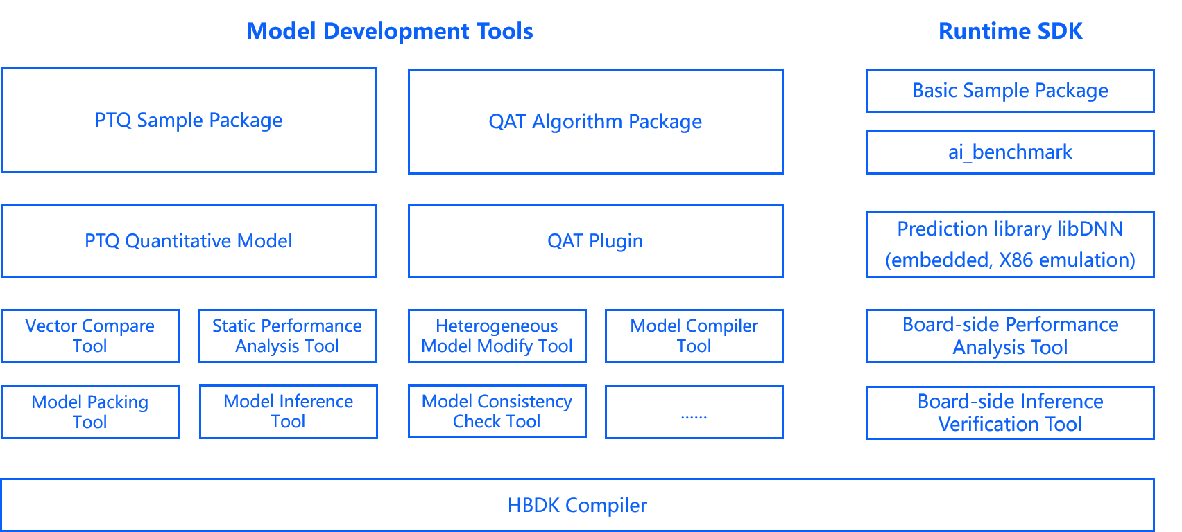

The toolchain consists of PTQ, QAT, embedded compilation, etc. The schematic diagram of the toolchain composition is as follows:
../../../_images/toolchain_framework.png
Among them:
Runtime SDK provides runtime library support for heterogeneous models. The runtime library contains two parts, ARM and x86, which are used to execute heterogeneous models on D-Robotics computing platform and x86 simulation platform respectively.
For more information about embedded application development, please read Embedded Application Development.
In addition, the toolchain provides rich development tools, samples, and model releases with a large number of built-in algorithmic models to help you get started and to improve the your development efficiency.

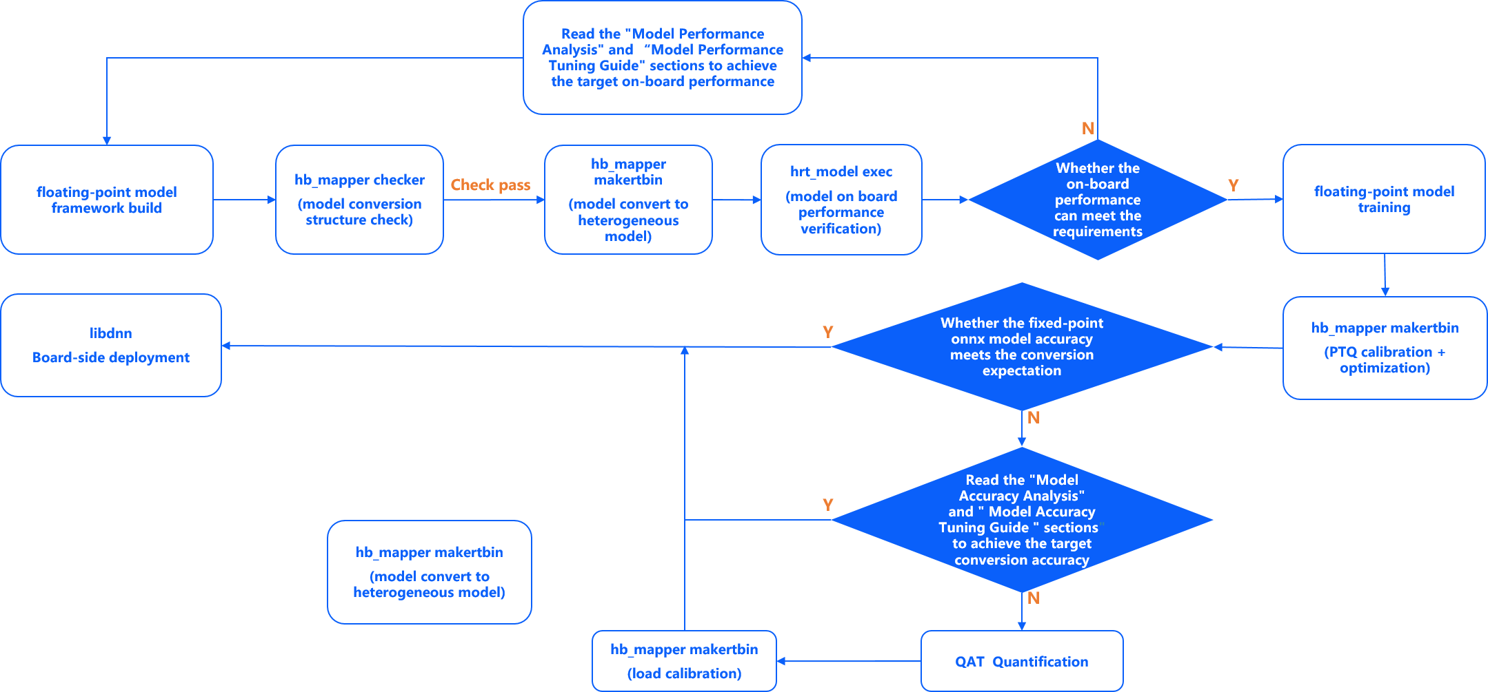

The overall workflow of using the toolchain is shown in the figure below. We recommend that you to try the PTQ method first to see if it meets your requirements on the deployment accuracy and performance.
../../../_images/usage_process.png
