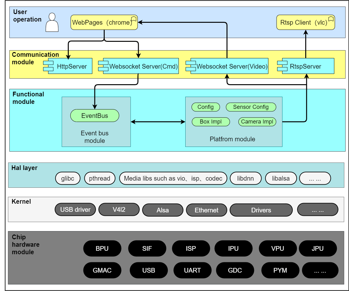

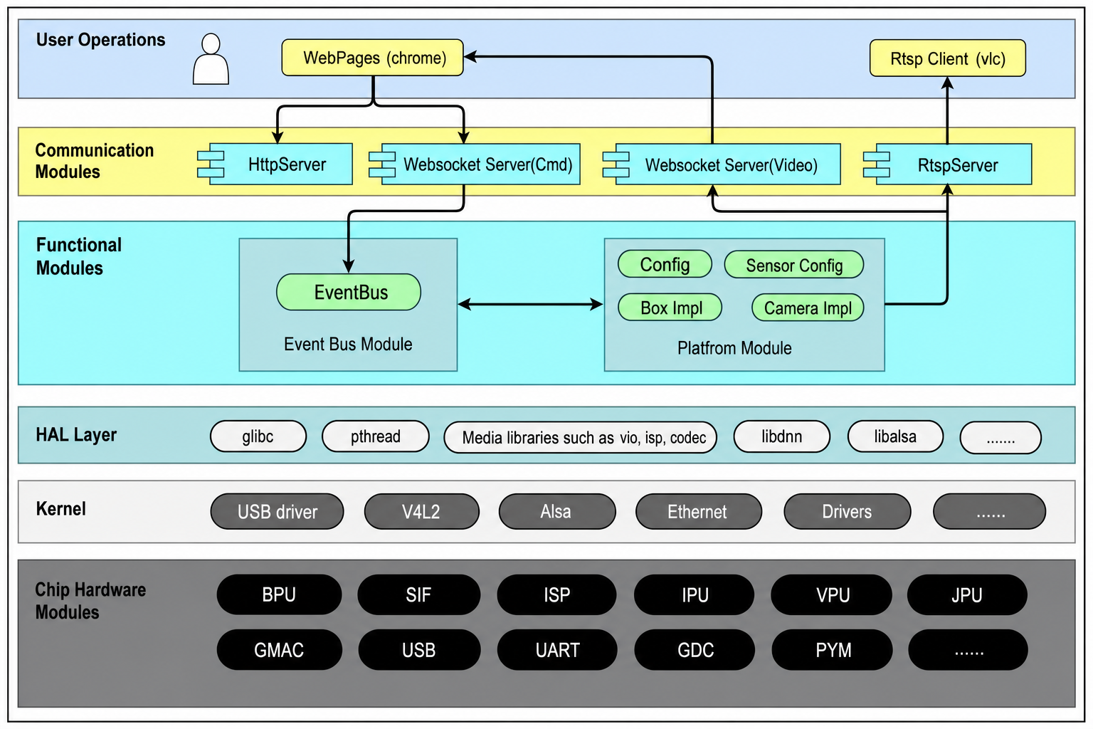

System Block Diagram​
Sunrise Camera implements multiple application solutions, such as intelligent cameras and intelligent analytics boxes.
The Sunrise Camera source code includes the WebPages layer (user interaction layer), communication module layer, and functional module layer. This document primarily introduces the design of these three modules.
The HAL layer modules include multimedia-related module calling interface libraries, BPU module inference libraries, etc.
The kernel version includes standard driver libraries as well as the system BSP.
The software block diagram is shown below:
sunrise camera software architecture layers

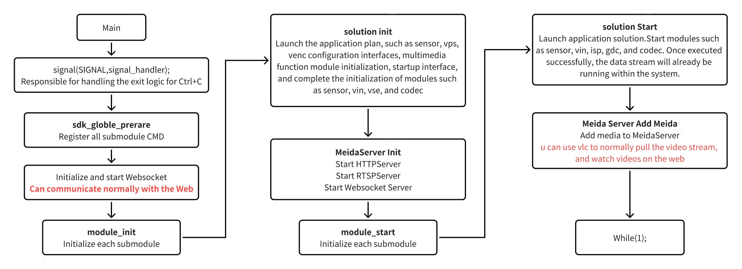

Main Program Entry (main)​
Overview​
Entry point of the main program and module startup.
The current basic submodule startup sequence is as follows. Note that the startup order must follow the dependency relationships among submodules.
Execution Flow​
sunrise camera main program startup flow

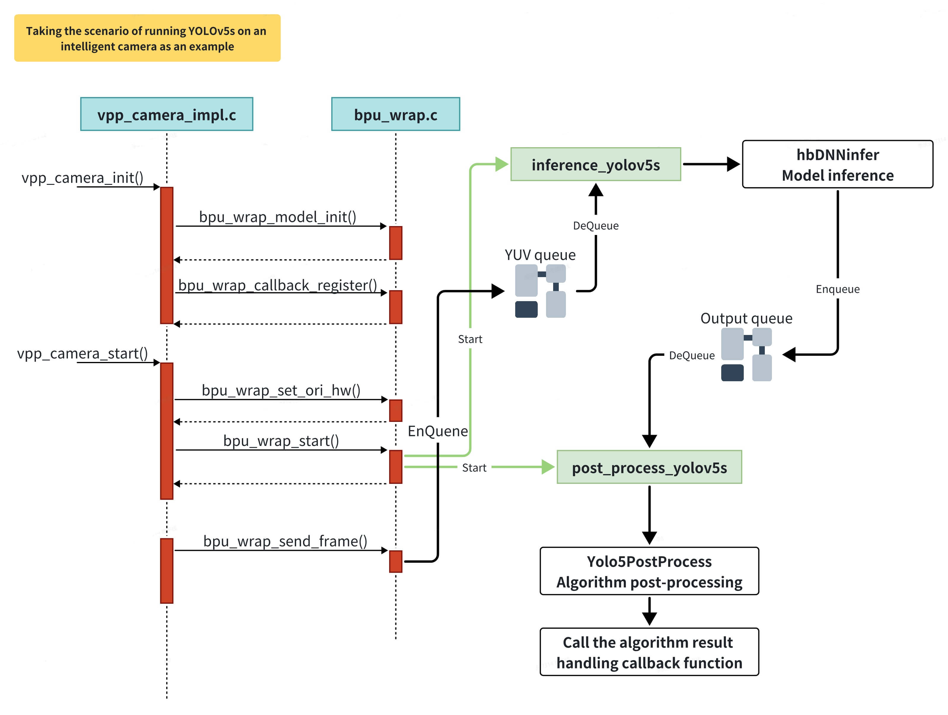

Performing Algorithm Inference Using BPU​
Overview​
This module handles algorithm model loading, data pre-processing, inference, post-processing, and returns results in JSON format.
The module's runtime sequence is as follows:
BPU yolov5s inference and post-process flow

Inference thread handlerbpu_wrap.cIn the handler, prepare output tensors, call hbDNNInfer for inference, and push results into the output queue. Example: inference_yolov5s
Post-processing threadbpu_wrap.cRetrieve algorithm results from the output queue, apply post-processing, and generate a JSON-formatted result string. If a callback is set, invoke it. Example: post_process_yolov5s
Post-processing codeyolov5_post_process.cppEach algorithm model requires corresponding post-processing logic—for example, mapping classification IDs to class names or mapping detection boxes back to original image coordinates.

In the inference thread, prepare output result tensors; dequeue YUV data from the YUV queue; call HB_BPU_runModel to perform inference and obtain results; then push the results into the output queue for post-processing.
static void *inference_yolov5s(void *ptr)
// Prepare model output node tensors; use 5 rotating output buffers for simplicity.
// In theory, post-processing should be faster than inference.
hbDNNTensor output_tensors[5][3];
int32_t cur_ouput_buf_idx = 0;
for (i = 0; i < 5; i++) {
ret = prepare_output_tensor(output_tensors[i], dnn_handle);
if (ret) {
SC_LOGE("prepare model output tensor failed");
return NULL;
while (privThread->eState == E_THREAD_RUNNING) {
// Get image data for algorithm processing; format is typically NV12 YUV
if (mQueueDequeueTimed(&bpu_handle->m_input_queue, 100, (void**)&input_tensor) != E_QUEUE_OK)
continue;
// Perform model inference
ret = hbDNNInfer(&task_handle,
&output,
&input_tensor->m_dnn_tensor,
dnn_handle,
&infer_ctrl_param);
// Enqueue data for post-processing
Yolo5PostProcessInfo_t *post_info;
post_info = (Yolo5PostProcessInfo_t *)malloc(sizeof(Yolo5PostProcessInfo_t));
mQueueEnqueue(&bpu_handle->m_output_queue, post_info);
cur_ouput_buf_idx++;
cur_ouput_buf_idx %= 5;
Post-Processing Thread Function​
