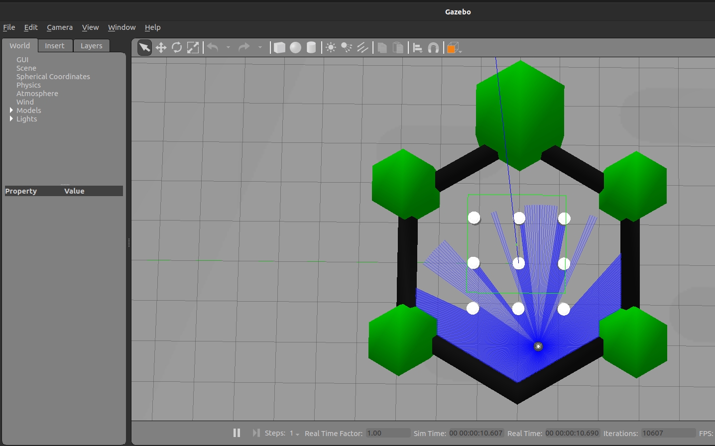

PC端启动仿真环境:
source /opt/ros/foxy/setup.bash
export TURTLEBOT3_MODEL=burger
ros2 launch turtlebot3_gazebo turtlebot3_world.launch.py
仿真环境如下图所示:

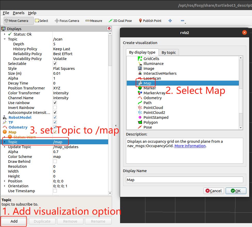

PC端开启另外一个控制台,启动Rviz2 用于观察建图效果:
ros2 launch turtlebot3_bringup rviz2.launch.py
打开Rviz2后,需要添加“map”可视化选项,用于展示建立的地图,步骤如下所示:

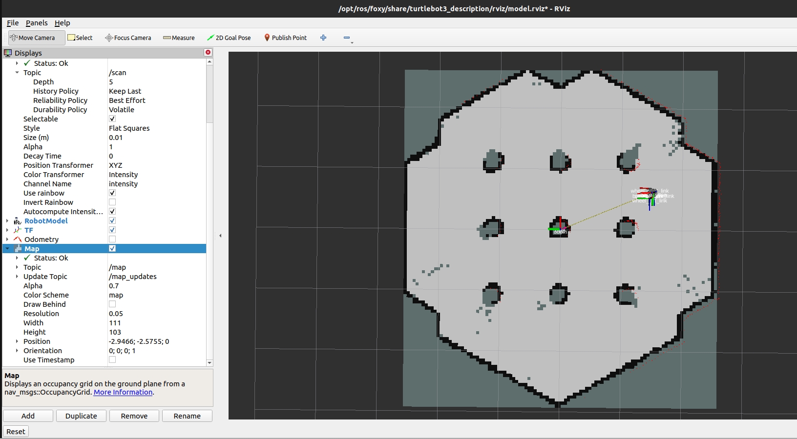

控制小车行驶,随着小车雷达探测到更多的环境信息,SLAM算法也建立起环境地图,可以在Rviz2上观察到建图效果。
结果分析
在旭日X3派板端运行终端输出如下信息:
[INFO] [launch]: All log files can be found below /root/.ros/log/2022-06-10-06-40-34-204213-ubuntu-5390
[INFO] [launch]: Default logging verbosity is set to INFO
[INFO] [sync_slam_toolbox_node-1]: process started with pid [5392]
[sync_slam_toolbox_node-1] [INFO] [1654843239.403931058] [slam_toolbox]: Node using stack size 40000000
[sync_slam_toolbox_node-1] [INFO] [1654843240.092340814] [slam_toolbox]: Using solver plugin solver_plugins::CeresSolver
[sync_slam_toolbox_node-1] [INFO] [1654843240.096554433] [slam_toolbox]: CeresSolver: Using SCHUR_JACOBI preconditioner.
[sync_slam_toolbox_node-1] Info: clipped range threshold to be within minimum and maximum range!
[sync_slam_toolbox_node-1] [WARN] [1654843589.431524393] [slam_toolbox]: maximum laser range setting (20.0 m) exceeds the capabilities of the used Lidar (3.5 m)
[sync_slam_toolbox_node-1] Registering sensor: [Custom Described Lidar]
