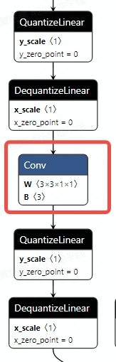

4.2.3.4.2.4. horizon_plugin_pytorch.utils.onnx_helper.export_to_onnx
In non-heterogeneous mode, this interface is only used for visualization; In heterogeneous mode, this interface can also be used to export the onnx for docking to hb_mapper.
def export_to_onnx(
    model,
    args,
    f,
    export_params=True,
    verbose=False,
    training=TrainingMode.EVAL,
    input_names=None,
    output_names=None,
    operator_export_type=OperatorExportTypes.ONNX_FALLTHROUGH,
    opset_version=11,
    do_constant_folding=True,
    example_outputs=None,
    strip_doc_string=True,
    dynamic_axes=None,
    keep_initializers_as_inputs=None,
    custom_opsets=None,
    enable_onnx_checker=False,
    """This interface is basically the same as torch.onnx.export, which hides the parameters that do not need to be modified. The following parameters should be noted:
        `model`: Models to be exported
        `args`: Model input, used for trace model
        `f`: Saved onnx file name or file descriptor
        `operator_export_type`: Export type of operators
            1. For non-heterogeneous models, onnx is only used for visualization, and it is not necessary to ensure actual availability. The default value is OperatorExportTypes.ONNX_ FALLTHROUGH
            2. For heterogeneous models, onnx needs to be available in practice. Use None to ensure that the exported operator is a standard onnx operator.
        `opset_version`: It can only be 11. Plugin has registered specific mapping rules in opset 11.
        Note: If you use the public version torchonnxexport, you need to ensure that the above parameters are set correctly, and use import horizon_ plugin_ pytorch.utils._ register_ onnx_ Ops to register specific mapping rules with the opset 11.

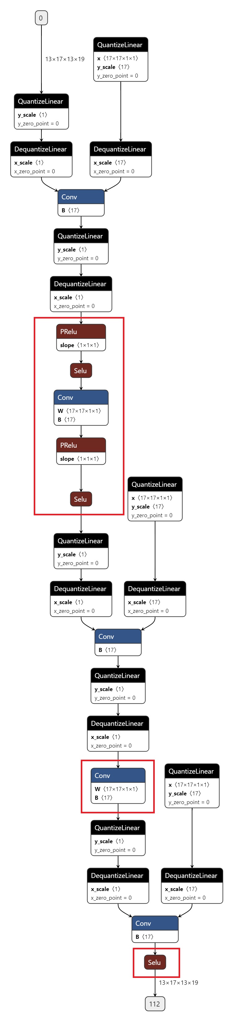

  10. Call export_ to_ onnx. You can also use torch.onnx.export , but you need to follow the precautions in the export_to_onnx interface description.
  11. Use hb_mapper to transform the onnx model. After conversion, it is necessary to check whether the operator is running on the expected device. In some cases, hb_mapper still needs to set the run_on_cpu parameter. For example: although conv is not quantized in the QAT stage, since its input (the output of the previous operator) has been fake quantized, hb_mapper will still quantize it by default.

        return self.dequant(x)
# Set march
set_march(March.XXX)
data_shape = [1, 3, 224, 224]
data = torch.rand(size=data_shape)
model = HybridModel()
# prepare_qat_fx will make inplace changes to the float model. Do not run inference on the float model until after prepare_qat_fx.
float_res = model(data)
calibration_model = prepare_calibration_fx(
    model,
        # Calibration fakes quant is only used for statistics. The unused calibration fake quant in the QAT stage will be automatically removed, and no special setting for high-precision output op is required
        "": get_default_calib_qconfig(),
    hybrid=True,
    hybrid_dict={
        "module_name": ["conv1.conv", "conv3"],
        "module_type": [_SeluModule],
# The calibration phase should ensures that the original model will not change
calibration_model.eval()
for i in range(5):
    calibration_model(torch.rand(size=data_shape))
qat_model = prepare_qat_fx(
    calibration_model,
        "": get_default_qat_qconfig(),
        # Selu is the CPU operator. Conv4 is actually the output of the bpu model.
        # It is set to high-precision output
        "module_name": [("conv4", get_default_qat_out_qconfig())]
    hybrid=True,
    hybrid_dict={

The exported onnx is shown in the figure. The part circled in red is the CPU operator.
